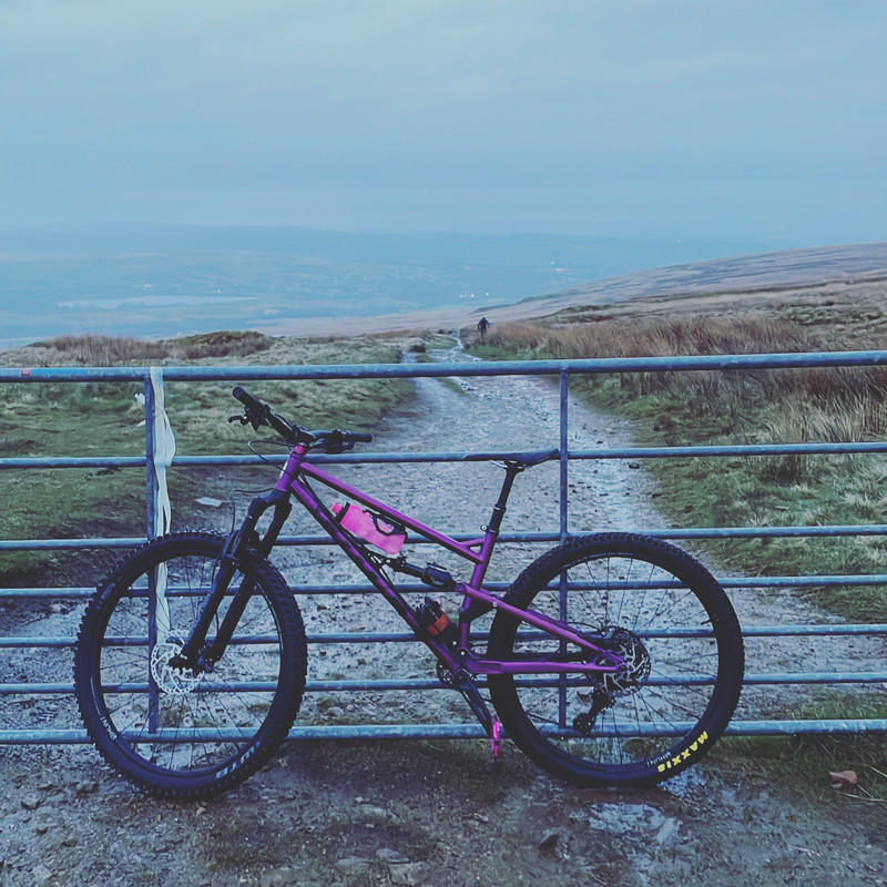

Loving my Flaremax. I only got it replace my HT but it's rapidly replacing my Patrol too.
130mm Revelations feel plenty
https://i.postimg.cc/hjpHmsrT/14-DA74-A0-F27-D-4584-A541-EE56-C4565497.jp g" alt="Flaremax" />

Posts: 1288
Flaremax
Posted : 25/04/2022 11:16 am

The purple does look awesome! What size frame do you have @tops5? I've been wondering if a water bottle would fit on my medium frame.
Posted : 25/04/2022 11:41 am
Posts: 1288
@woodlikesbikes thanks mate 🙂 It's a medium and the bottle is a tight squeeze!

Posts: 2980
Lovely stuff. Top of San Marino eh? What fork did you go for?

Posts: 1288
Yep running well ATM
I went for Revelations at 130mm

Bit of an update following a few rides. Did Gisburn first to ride somewhere familiar, then Rivington a couple of times. Got some local knowledge which was much appreciated 😜
First off, quickly find a natural riding position. It's comfortable and doesn't feel alien like it did the first time I got on it!
I feel like it's taking a lot of tweaking to get the suspension right. I think the fork feels pretty good now, put a few more psi in before setting off today, took all the compression off. First run down a rooty trail and it felt rough, couple of clicks HSC compression and it felt much better.
The shock and rear end has not been feeling as plush as i thought it would. I've got the sag about right, but it still feels a little harsh somehow. It's good, but I think it could be better. Doesn't help that I don't really know what I'm doing 😜
Pinch flat on second ride, can't get it to seal so there's a tube in the rear now. Waiting on a dynaplug repair kit to try and sort it. Dinged the rim as well (Hunt trail wide.) 7 yrs on stans arch ex and I never put a dent in the rim!?
So a tube in the rear plus the weight of the frame bag (with tube, co2 etc) plus water bottle makes the rear feel heavy. I don't think this is a major thing, just that I need to adjust my weight more effectively. Sometimes when I'm popping off something, either I don't pull the back up enough or try too hard and nose dive. I reckon I'm so used to my old bike, I need to relearn my body positioning.
Riding down some steep, twisty, rooty trails today and it does feel great. When it's real steep I feel like I can get down into a much more stable position. I feel more confident in the front end then I ever did on my old bike, not as afraid of it washing out. Don't feel the need to change the tyre (WTB Verdict) but then maybe it could be even better!?
I feel like I'm more willing to tackle steep off camber stuff, I'd like to do a back to back run on my old Transition, see if I'd make it down!
Riding up stuff feels fine. Easy enough to sit and spin, the weight isn't an issue here. Strangely, it's less floppy than my old bike despite being a lot slacker, thought it would be all over the shop but it's easy to keep in a straight line.
Moving from SRAM to Shimano gearing feels fine, lovely and light feeling. XT brakes should be plenty powerful enough. The oneup dropper feels great with the Shimano lever.
Thought I might need to chop the bars down from 780 to 760, but I'll stick with it for now. Think I like them!
Also assumed I'd need to change the cotic saddle, but actually it's bloody comfortable. That's staying.
Went for dmr v12's instead of vaults. Lighter and cheaper. Think the platform is slightly smaller, but they feel no different when riding. Plenty grip with freeriders.
Got a cheap zefal side load cage. Pleased to find an 800ml bottle fits no problem 👌
Only a few more weeks till ardrock, that'll be a good test. Hopefully get a few more rides in before then.
Will post up a few more pics in a bit.
Fyi - wheelbase is 107mm longer than the scout. Wonder if it fits on the Thule 591!!?
Posted : 04/07/2022 8:18 pm
Posts: 2980
https://ibb.co/GcHf7Bp
https://ibb.co/M59QnVC
https://ibb.co/GTLyzSS
https://ibb.co/Jv1n2C8
Close up of the frame bag.
Large bottle in a large frame!
Should really try to get a close up of the paint, it's for a nice sparkle to it
Posted : 04/07/2022 8:38 pm
