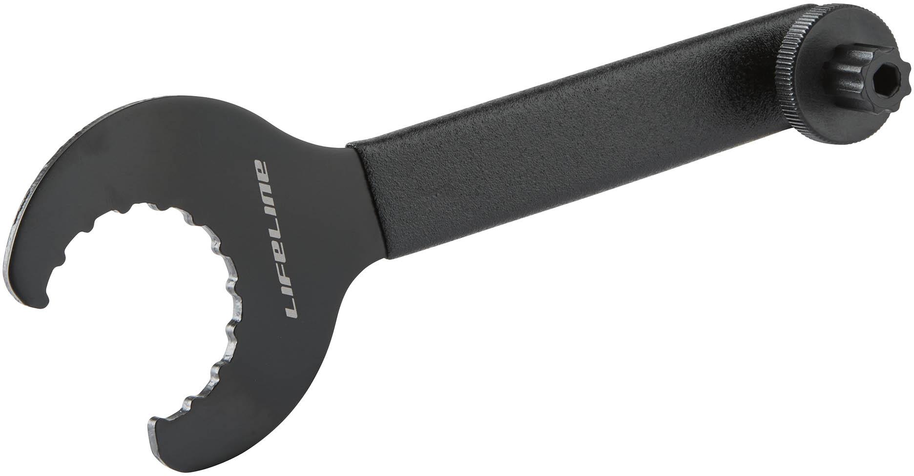

Just wondering whats tricky with shimano, seat everything, use the (shimano supplied) tool to provide endload, tighten the pinch bolt to "quite tight". Ride bike.
I've done hundreds.
The only ones i've seen screwed up are those who use a massive long spanner for the preload. Christ, you can provide the requisite preload by pushing the crank arms together with your hands, you don't need a 10" spanner. It's almost like when the aheadset was launched, selling aluminium top caps to idiots who didn't read the instructions and tightened the top cap in the same way you tighten an expander bolt...
And those who tighten the pinch until the slot closes up, which is going to be 20-25 Nm at least. Which is a lot.
But still i've seen it done lots of times (usually stems clamping onto steerers or bars).

Nixie - on all tools I've seen similar to the one you posted, the preload tool spins on a locating pin - just to save you from losing it. The lever does nothing with respect to the preload tool as it is independent.

Nixie – on all tools I’ve seen similar to the one you posted, the preload tool spins on a locating pin – just to save you from losing it. The lever does nothing with respect to the preload tool as it is independent.
Exactly this. I don't think I've ever seen a tool like that with a "fixed" handle.

I don’t think I’ve ever seen a tool like that with a “fixed” handle.
A mate of mine has a 1/4" square drive shimano preload tool. And i've got a spanner in my tool box (it's not even 3" long, so not a big deal) they also have 1/4" hex bit inserts and tools with a 6mm hex hole in the middle, so they are out there.
