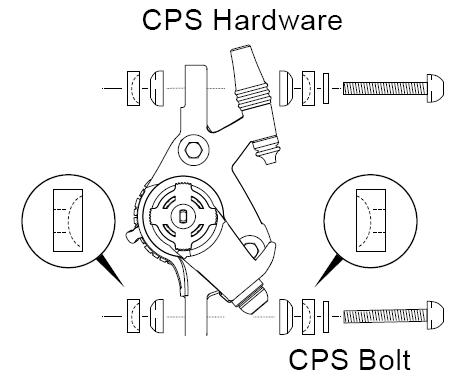

As you can see [url= https://www.sram.com/avid/component/hydraulic-disc-brakes ]here[/url] some Elixir brakes use avids CPS caliper mounting system (cup and cone washers each side of the caliper) some don't.
If you have a caliper that does (it sounds like it, you mentioned running with 160mm rotor and 'some washers') then the shimano adaptor is not suitable and WILL damage your fork as the bolts are not long enough for additional washers. [edit]and moving them washers to under the caliper will mean the heads of the bolts will now be sitting against the caliper at an angle, so will likely slip or come loose[/edit]
If you have a caliper that does NOT use CPS, then the shimano adaptor would have worked with the caliper against it and the included (with the shimano bolt) cup/cone washers under the bolt heads.
I.E. It is highly likely you have CPS and as such now have the wrong adaptor.

Im not surprised you struggled, im struggling and I know what im looking for. It seem the old style adaptors have been phased out and what you now need is apparently a 20 S/20 P.
[url= http://www.sram.com.cn/sites/default/files/techdocs/95-5018-000-000_rev_b_disc_brake_caliper_mounting.pdf ]Instructions[/url]
I.E. this... [url= http://www.chainreactioncycles.com/avid-disc-brake-spacer-set-hardware/rp-prod108156 ]adaptor[/url] basically just longer bolts and some big washers.

Most avid brakes used to use CPS washers, this was built into the design, you need to use them at all times.
So if you had all those when bolted to your fork originally you still need to use them with an adaptor. The avid adaptor I linked includes them for that purpose. Those other adaptors would uses your existing bolts and CPS washers.
Unless you have a new avid which does not use CPS, you need to determine that from my previous link to the instructions.

I bought the CPS hardware pack mentioned by Stato, above.
I'm using a 20mm post mount, with the longer screws, and CPS washers either side of the caliper.
