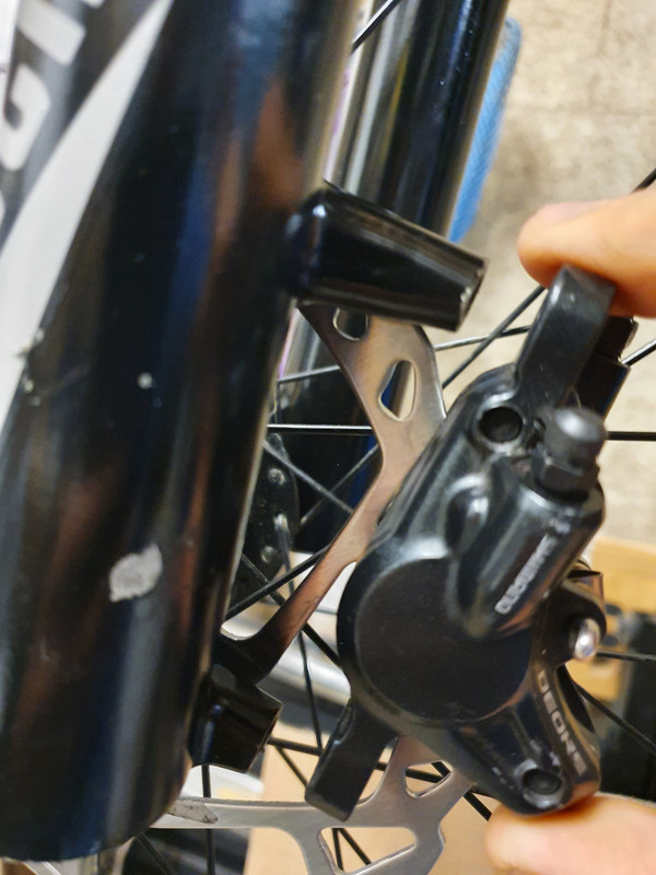

I'm having to resurrect this thread as I must have done something wrong! I thought that I didn't need an adapter between the calliper and post mount on the fork
So I have Deore M615 brakes that I'm trying to put on my 2016 Revelation (FS-RVL-RC3-A3). I've used a 180mm shimano rotor and yet the calliper won't sit on the direct mounts.
I'm thinking I do need some kind of adapter. Can someone please help me with identifying what I need?
Is it an international - A adapter like SM MA F180P/S or SM MA F180P/P2?? I'm really confused now.
Posted : 13/04/2022 6:07 pm

The SRm website for your fork has the spec muddled up. But the slightly new A5 fork has a minimum rotor size of 160. Suggesting that the fork has 160 post mounts.
If you have a 180 rotor. You need this adapter. Click here CRC (the 160 to 180 version)
Your photo confirms this.
Posted : 13/04/2022 11:21 pm

I have 160mm rotors, but I went out and specifically purchased a 180mm one because of the spec sheet of the fork and didn’t want to risk under sizing the rotor - I even checked it with Rockshox facebook support, humph. I’ll change that over to the 160mm and see how it seats and report back!
Posted : 14/04/2022 7:37 am
Posts: 2655
Revs didn't change to 180mm post mount until they changed to 35mm stanchions with the 2018 onwards models.
Posted : 14/04/2022 7:52 am
So put a 160mm rotor and and it seats fine. Ruddy manual and RS information (even facebooked them to check I needed a 180mm rotor before buying it).
Posted : 15/04/2022 6:59 am
