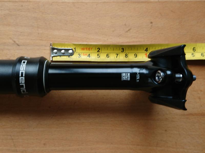

Posts: 2314

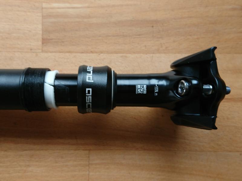

Assuming your dropper is similar to the 120mm Brand X stealth I just bought, the shim will only fit if the post is slightly compressed. Unscrew the collar and slide out the white bush, the 3 prong shim should then slide in the channels below the bush at the back of the dropper;
Brand X opened

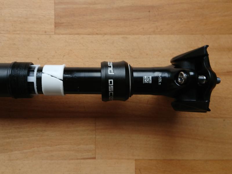

Then you need to compress some more to slide it down until the white bush is back in place;
Brand X bush
Then put the collar back in place, when you extend the dropper you now have a custom length, in this case 120mm down to 80mm or so as I put in a full shim.

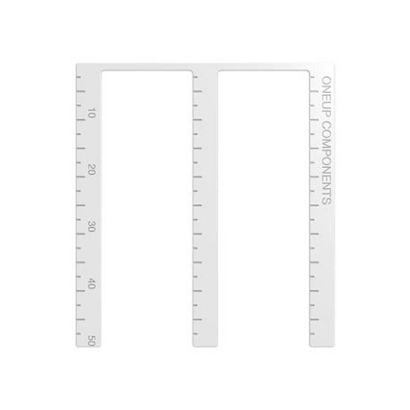

If you want 100mm (or any other length) you just cut the shim down. Shim looks like this;
OneUp Dropper Shim
