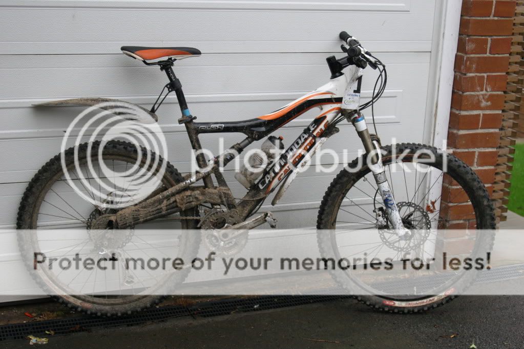

After riding with a friend recently who rode a Santa Cruz Superlight I was really suprised how light it really was. Guess the clue is in the name. It was running at around 23lbs.
With this in mind I thought I'd weigh my bike a 2008 Cannondale Rush Carbon 4. well I got a shock it was 30 lbs 🙁
Obviously I weighed it when it was clean & without the bottle and guards.
All the parts are standard bar the Thomson seatpost and stem, which can only help. But where's all the weight coming from......wheelset, drivetrain, frame, fork? Is there anything that stands out as holding the weight?
Am I just comparing two massively different beasts.......is 30lbs reasonable for what I have?

Thomson seatposts and stems are not light. Solid and well made, but not light.
What wheels and tyres are toy running? Your saddle looks chunky as does the silly mudguard thing.
Both sets of scales might be dodgy though - his must be full on bling to be be 23lbs while your might be nearer 28 than 30.

No stand out parts, probably just carrying a bit of weight on everything.
Quick gains to be made from finishing kit: seatpost, stem, grips, saddle, and other bits like cassette. Wheels for a big saving.

Its on the standard Mavic 317 rims with Intense 404 tyres. 🙁 thought Thomson would have been light.

Intense tyres, swap for somethign more Xc and you'll shed about 4lb!
Big rotors are supprisingly weighty, stick with 160/160 on lightweight bikes.

Beat me to it. Those tyres aint the lightest by a long stretch. You can save a fair bit of weight on rotors, say by going to ashima (horrible) but it looks like your already running a 180, 140??
Not sure what saddle you're running there either, some very light saddles out there, an easy way to save 100+ grams for most people.
Wheels, tyres, saddle, rotors and some carbon bars would shave some weight.

ps my saddle is a standard fat fizik saddle, but it is a comfy one!

its a decent frame with low to midrange components
where is the weight?
everywhere
from evans
Gears: Shimano LX Front Derailleur with Shimano XT Shadow SGS Rear Derailleur
Shifters: Shimano LX Rapidfire Plus
Chainset: Shimano XT with 22/32/44 Tooth Chainring
Brakes: Avid Juicy 5 White with 160mm Rotors
Wheels: Mavic XM 317 Disc 32 Hole Rims with DT Swiss 370 Hubs
Tyres: Hutchinson Piranha 26 x 20
Handlebar: FSA XC252 AOS 25mm Rise
Stem: FSA OS150 31.8mm
Saddle: Fizik Nisene Sport
none of that is light
cassette is probably a boat anchor as well
