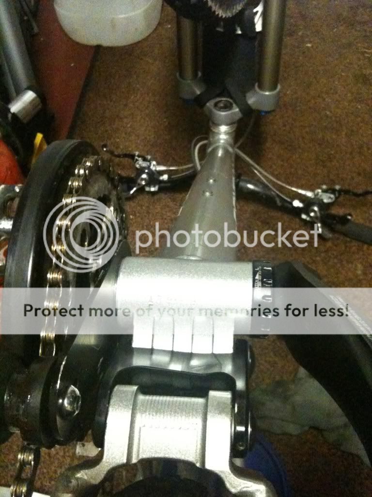

The lower linkage has taken only small hit at the weekend and it has dented it slightly, so where can you get Intense parts in the UK, does anyone make them here or do I have to go and ask the lovely people of the USA to help me out.

i'd ride that and not worry

Was thinking that, but will it be a bugger when I come to replace the bearings?
Posted : 15/12/2010 7:10 pm
Unbolt the shock and see if the swingarm moves freely, if it does then it's ok, if it binds when going through the travel then it's twisted and needs a new link
Shouldn't affect changing the bearings

As above - I wouldn't worry. [url= http://www.extrauk.co.uk/profile/about/ ]Extra[/url] are the UK importers though and are very helpful - give them a call/email.

Everything seems to be moving ok, will ride till I die!
