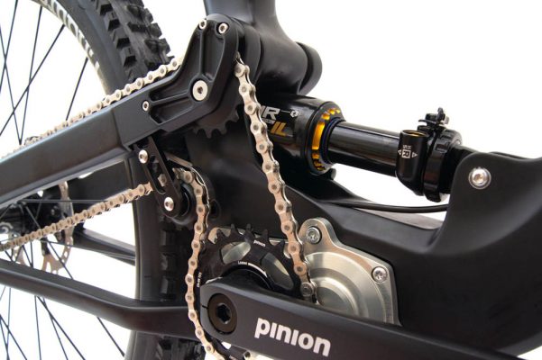

Looks nice but don't understand the extra sprocket above the cranks. It just causes less contact on the chainring which will lead to faster wear.
Posted : 24/08/2021 1:03 pm
Posts: 4704
is at or about the main pivot location on this particular bike.
with the pivot up high and no idler pulley, it will pedal like poo and chain growth will be massive - a particular problem with only the little tensioner on the rear.
Posted : 24/08/2021 1:05 pm

Looks nice but don’t understand the extra sprocket above the cranks.
https://www.pinkbike.com/news/tested-how-much-slower-are-idler-bikes-when-climbing.html
In practice, no. Only the first few links of the chain that contact the chainring are actually taking the load.

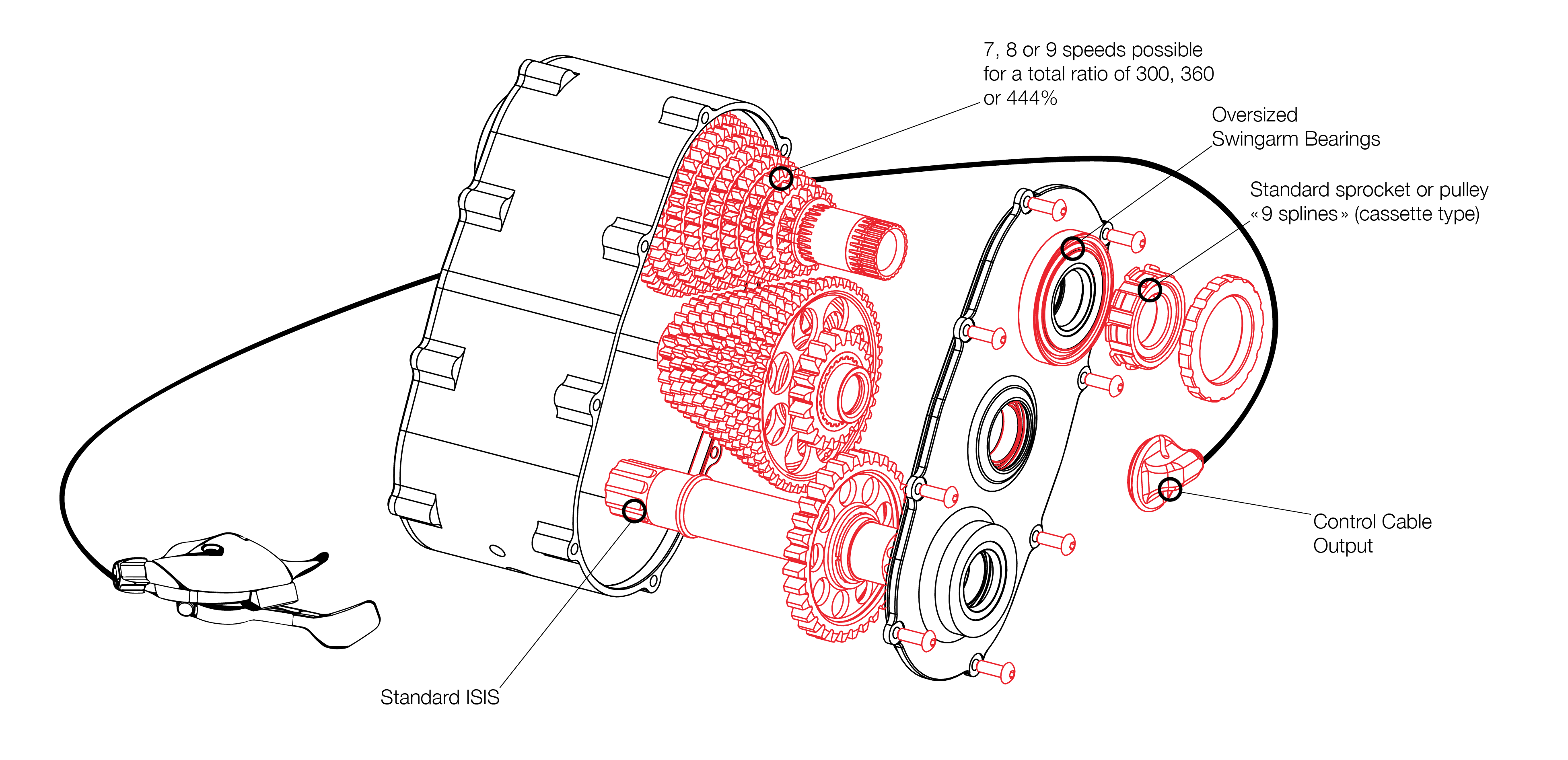

until there’s a standard for mounting them to frame so you have choice of which gearbox you go for, the cost comes down and the friction/drag is dramatically reduced, it won’t take off at all and will remain a niche.
This comes up about once a month. A gearbox needs precision machining. It will always be more expensive than a derailleur system. Friction is inherent to gears. It will always be a bit draggier than a chain. Whether it's enough to worry about is a different question, but a cheap gearbox with the same efficiency as a chain is a fantasy.

Gearbox bikes allow designers to run a high pivot an route the chain around a sprocket at that point. That makes a huge difference to suspension performance downhill.
Removing 500g from the rear wheel will always have a positive effect, but it's not enough to stop DH racers running big heavy tyres. Adding 1 kg around the BB won't make a noticeable difference to the sprung/unsprung mass given that the rider generally weighs 70 kg or more. If a bit of ballast down low made a huge difference, you'd see DH riders fitting water bottle cages to their bikes so they could add or remove water as ballast.
So: high pivot will make a big difference; lighter back wheel a small difference; heavier BB not worth the extra weight.

gearboxes have nothing (well very little) to do with pivot points.
Lots of people saying moving an air shock lower down is good so clearly moving the main weight of the bike would make a difference too.
To run a high pivot, you generally need to run an idler gear so that the chain forces don't affect the suspension. This is kinda built into gearboxes because the output shaft is in a different location to the input shaft so designers just need to package the gearbox to put the output shaft up high. Running a high pivot with regular cranksets and derailleurs is a bit of a bodge because you need to route the chain around an extra idler sprocket up high. Fine for a DH oriented bike but not great for most applications.
Moving the existing weight down is a good thing, no question there, but that won't change the sprung/unsprung ratio at all. To change that, you either need to reduce the weight of the wheel or swingarm, or increase the weight of the front subframe or rider. Adding extra weight as ballast in order to alter the sprung/unsprung weight ratio is probably counterproductive overall because an extra kilo is less than 2% of the weight of the rider. Factory DH teams generally do whatever they can to reduce weight, they don't build massively strong bikes that weigh 60 pounds and I've never heard of anyone ballasting a frame around the BB to improve suspension performance.
Posted : 25/08/2021 9:59 am

Nope, you're still wrong. The pinion has its output and input concentric plus the output on other gearboxes that aren't concentric may not be anywhere near where you want the pivot. The two things are no more connected than high pivots and standard gears.
Have you actually seen a gearbox?
Both the pinion and the new effigear have the output shafts in the same place as the input shaft. Making the gearbox big enough to have the output shaft high up enough for a high pivot bike would not only make the gearbox massive, it would make it incompatible with all other bikes not high pivot, and would make it incompatible with the standard pinion gearbox mount.
Posted : 25/08/2021 11:08 am
Posts: 12092
Here's a diagram of the Effigear transmission. It has pivot bearings built into the casing, concentric with the output shaft.
Posted : 25/08/2021 11:32 am
Posts: 5661
Yep, that's one model of the effigear, which is incompatible with the standard pinion mount for the 7 gearboxes they make, plus the new effigear mimic.
So yes you can design a bike around that single model of gearbox that's been out for at least 6 years. But that's a niche of a niche, so not exactly mass market.
Posted : 25/08/2021 11:45 am
