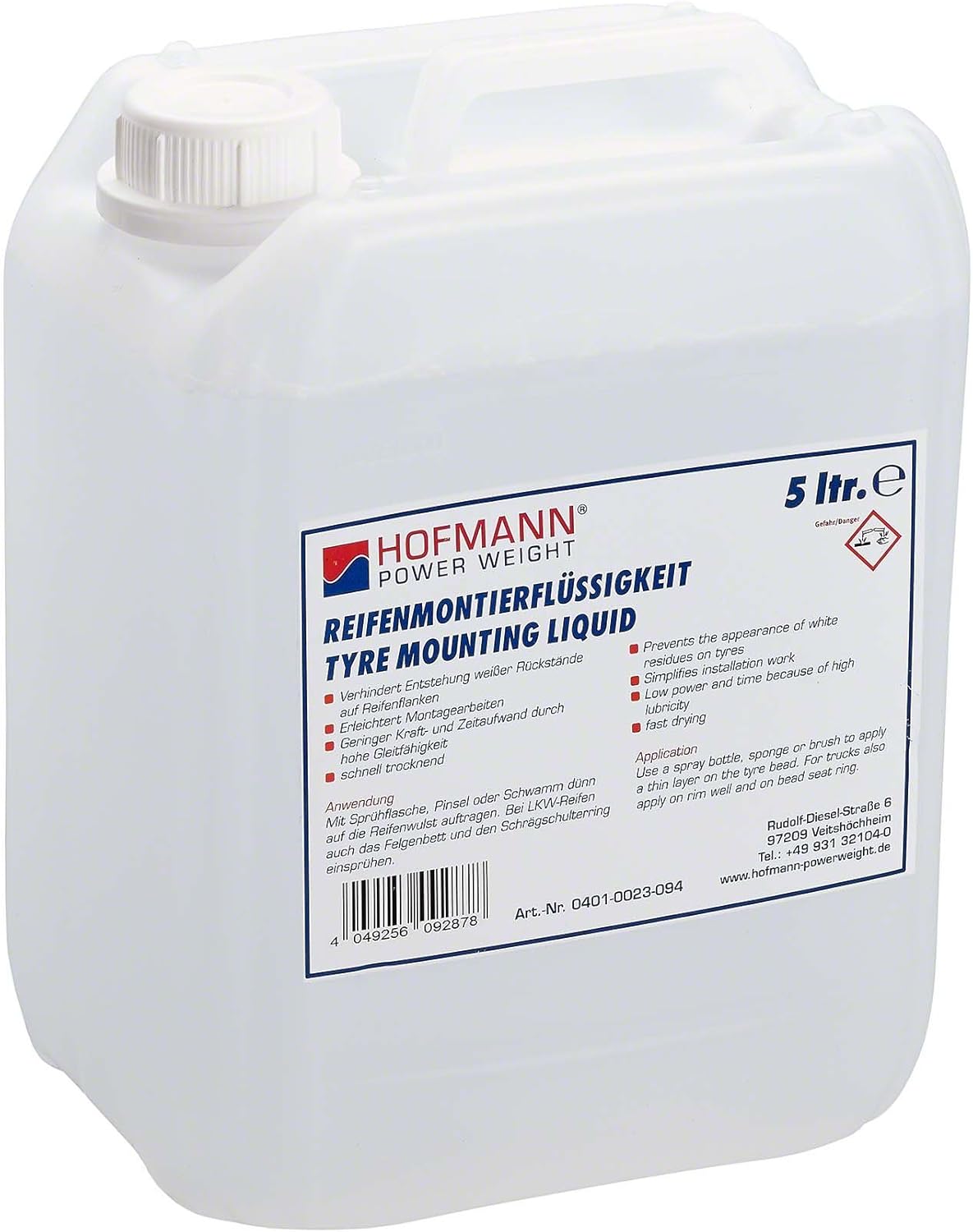

I spray some duluted washing up liquid round the rim and then inflate.
I'm sure someone will be selling "tyre mounting fluid" or something. After all, they can get folk to buy fancy tyre levers.
Posted : 27/07/2020 11:25 am

I’m sure someone will be selling “tyre mounting fluid” or something. After all, they can get folk to buy fancy tyre levers.
Posted : 27/07/2020 12:18 pm
