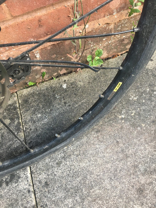

My rear wheel - 4 years old, not a crazy no. of miles on it, probably 50/50 on/off road, did this on the way home -
3 spokes, sheared off, all at once. Made for a right wobbly ride home, with worry that it would fold under me (it didn't).
Never have I checked spoke tensions (at the nipple), lubed spokes on any wheels and no wheel has done this before. I just keep em (reasonably) clean... should I be doing more, or is it Mavic shiteness..?

I have snapped a couple of toad spokes in the last year - bike shop replaced he first one, but I replaced the 2nd and at that point I went round and evened the tensions out as much as I could whilst still getting a straight wheel. My plan is to check them over again periodically but whether that happens or not I don’t know.
Your issue seems very bizarre - snapping 3 spokes at one - and not all on the same side of the wheel either.

My left crank arm broke last week and I thought maybe it had hit and weakened the spokes.. but I checked and am pretty sure it couldn't reach them.

Do the spokes bend sharply at the nipple or curved gradually?
Posted : 11/10/2019 10:30 am
Posts: 10225
Have the wheels got alloy nipples instead of brass perhaps? If so that’s not brilliant unless they were assembled well with loads of grease / line etc.
Dead straight both ends.
They're Mavic Pre-built wheels (Ksyrium Allroads).

Mavic wheel in spoke failure shocker!
Spokes look like they have failed at the classic week point in the root of one of the threads and have probably failed due to fatigue, made worse by the low spoke count which could have increased the max stress beyond the fatigue limit of the steel.
I don't think there is any maintenance that could have been done to prevent this. The cracks might have been detectable with a liquid penetrant inspection?
If you have kept track of how many miles this wheel has done, you now know when to get your wheel rebuilt, if you buy a replacement. Depending on the weight balance between the front and rear the front could be about to fail in exactly the same way.
Yes I think they are alloy nipples and spokes. They look like the ones I had on my old Mavic Crossmax wheels (and those wouldn't budge either using the plastic spoke tool). But in fairness those wheels actually held up very well for many years and were still going strong when I sold the bike. Never needed any maintenance, but I reckon the nipples were all seized up so would have been a nightmare had they needed any attention.

Had exactly the same issue with crossmax enduros a few years ago.  The nipples seized as well.  I was constantly replacing all the spokes as they snapped.   Absolutely awful wheels, cost a fortune at the time.  Lost a fortune selling them as spares or repair (albeit working at the time) in terms of maintenance I get my wheels checked annually usually.  Service my own bike but prefer a wheel builder to check spoke tension etc.  Once a year, if I keep wheels that long as a serial bike changer

If the wheels have been ridden all year on the roads, particularly in winter with salt, then stress corrosion cracking is the likely problem. The salty water gets into the threads, starts corroding which creates a point of weakness and accelerated fatigue failure. Quite common with Mavic and likely that the nipples are corroded solid in the rim so it probably means the wheel is toast as Mavic don't provide any spares support after a few years.

Update: One of the nipples was completely seized and disintegrated when I tried to remove it. So the wheel is trashed (it’s a UST so you can’t undo from inside the rim).
