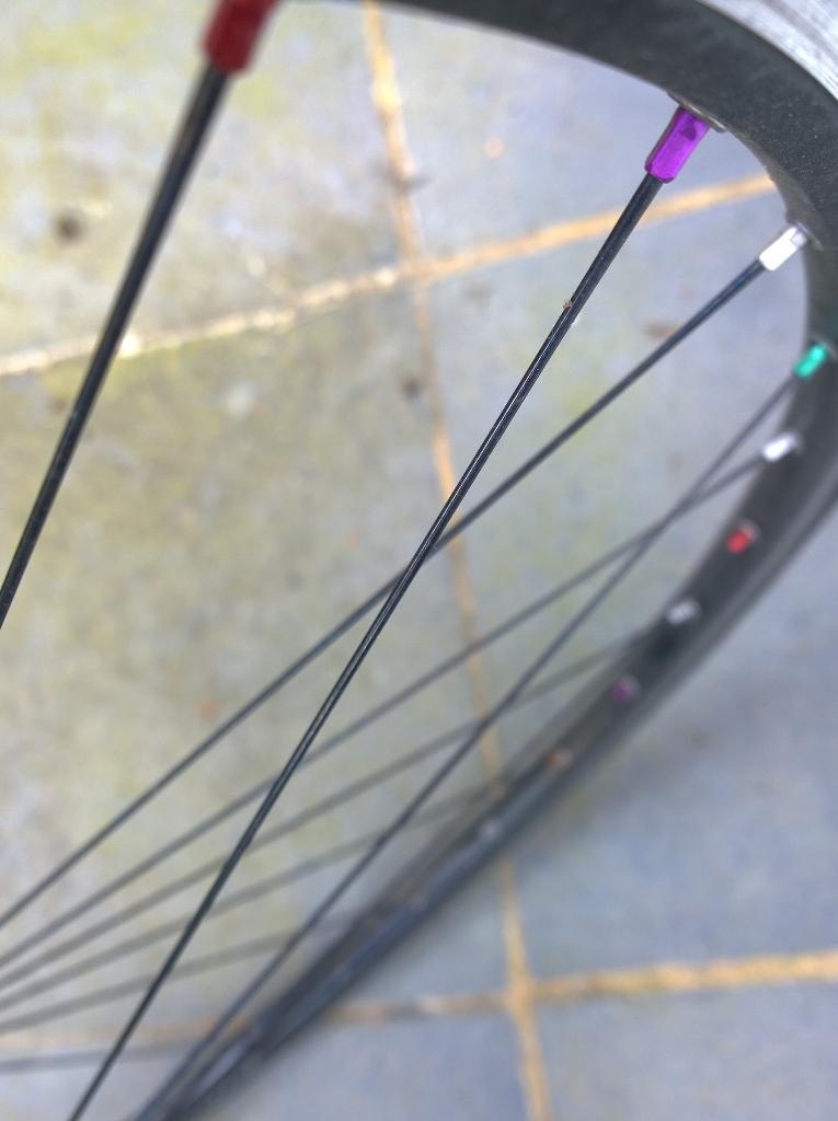

In vaguely related news, this is today's purchase. You don't get these and a dyno hub on an off-the-shelf pair of wheels 🙂

They're TLC rainbow brass nipples. I ordered from Alan's BMX as they seemed to be cheapest.
I'm more excited about them than a grown man probably should be 😉 but I've been having rainbow withdrawal symptoms now that I no longer have these:

I haven't used them before but I've ordered some this time just in case, as I've ordered some of the ACIs from Cyclebasket and I gather they can be a bit longer in the elbow than DTs.
Rainbow nipples have arrived (with a couple of bonus stickers). Nice.
