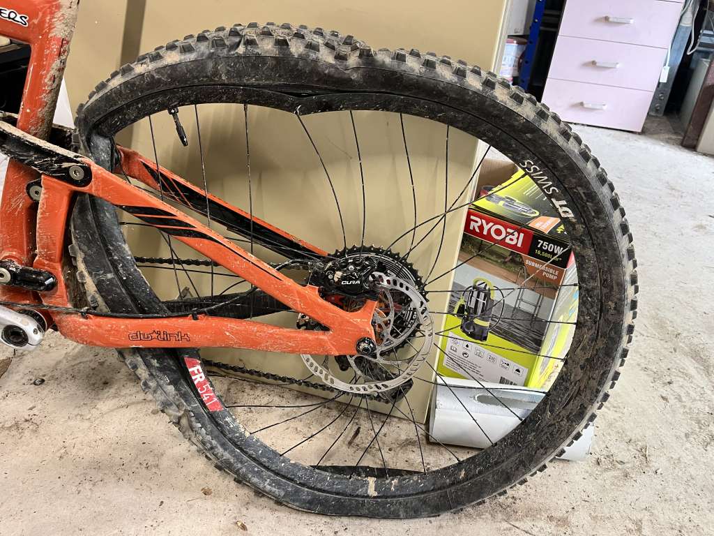

I trashed a hub on my 511 so decided to get a 541 wheel built and keep the 511 as a spare rim. <br /><br />
511 was great. 541 was pretty good… but not bullet proof* Glad I kept the 511 rim as it’s now being used again.
IMG_7056
*or drivingintoatreeproof for that matter.

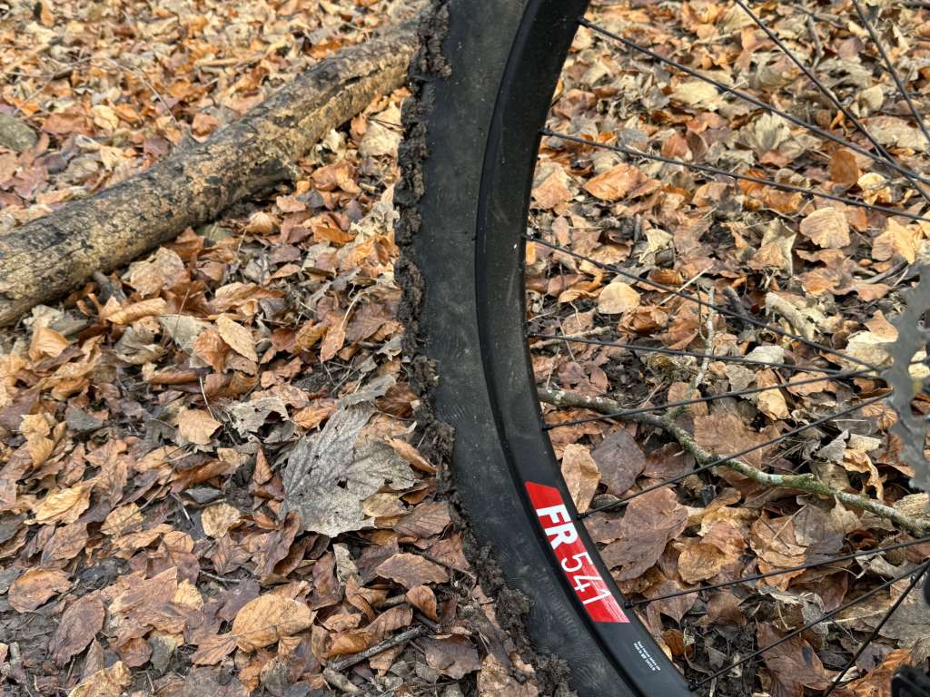

Posts: 677
Hah, oh no! I picked my wheel up today and took it for a ride. It is still round but I didn't **** it into a square edge (or drive it into a tree).
IMG_0475
