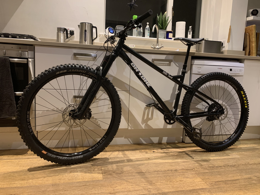

Dave
Posted : 14/12/2019 6:28 pm
Posts: 7561
Double top our kid.
Posted : 14/12/2019 7:05 pm
Looks good!! Happen to k ow what length seat tube it will accept?
Posted : 14/12/2019 7:09 pm
It's completely straight so I think the bb is your limit.
Posted : 14/12/2019 7:10 pm

What size is that @guandax
Looks spot on that

Yes Guandax, looks mint! A proper angle for the photo to show that HA there!
Posted : 14/12/2019 11:27 pm
Hmmm, looks like I've got a large not the XL I was expecting. Wish I'd measured before building 🙁

Oh nice Guandax, have you managed to get out and give it a good ragging? 😁
Posted : 15/12/2019 9:37 pm
Going to see if there's any chance of swapping out for an XL before riding it in anger.
Posted : 15/12/2019 10:03 pm

Hi I am running a dtswiss 35mm 27.5 with specialized 27.5x2.6 purgatory in rear and it's a perfect fit. Just enough clearance for mud. I would say that if you are putting a 29er in they it would be too tight
Posted : 22/12/2019 2:52 pm
Are those forks on the right way?
Edit, yes
Posted : 22/12/2019 4:19 pm
