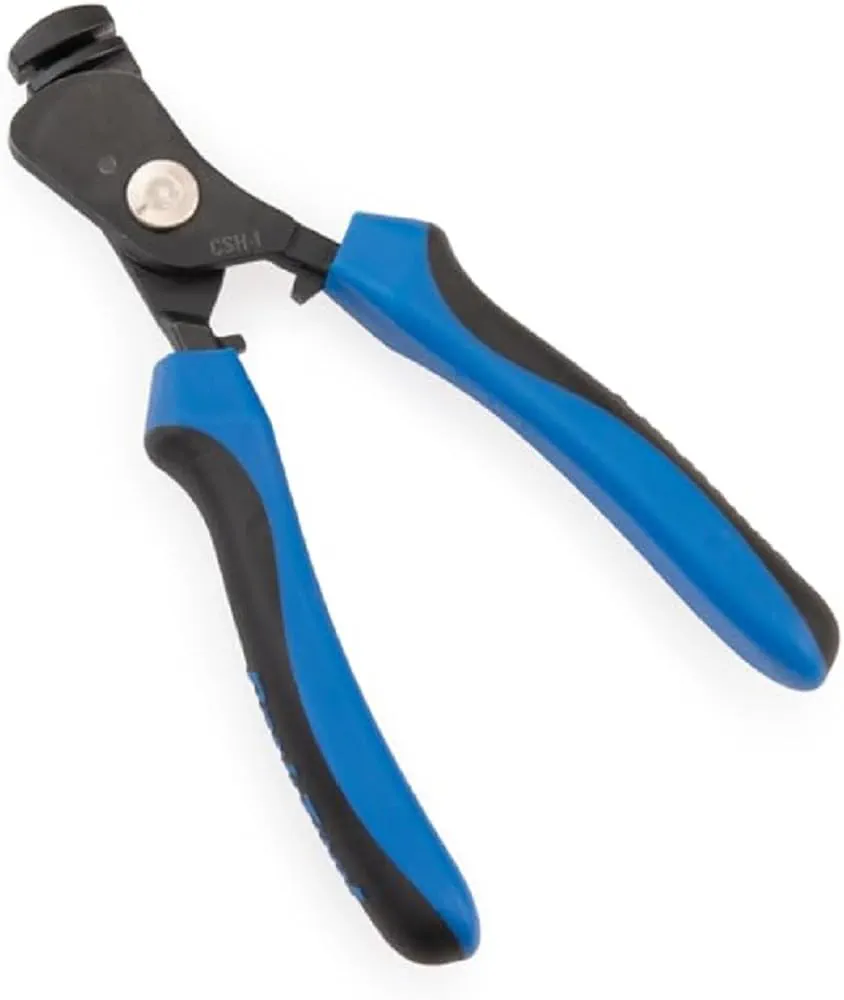

Was using my Park 'bladed spoke holder' tool for the first time today, and it looks like the perfect big plastic coated lever to de-stress spokes with, almost as if Park unofficially designed it that way : )
