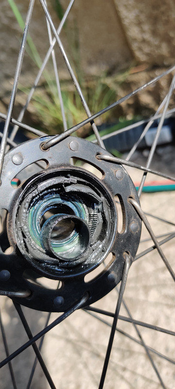

I'm not especially strong and not especially heavy, but I'm managing to do this to hope freehubs
hope freehub

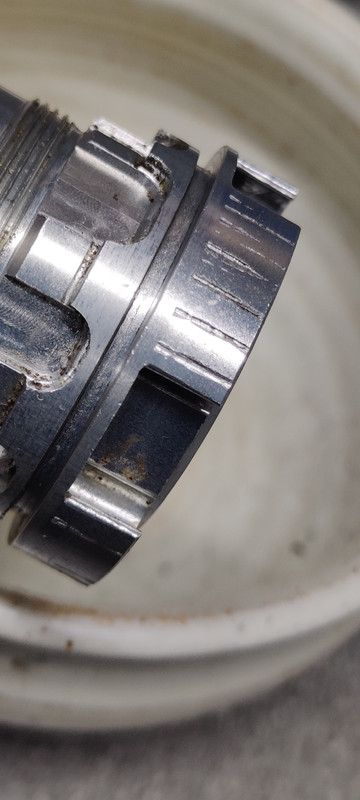

And this to Halo Supadrive
halo

The Hope problem stems from flexing of the hollow aluminium axle, exacerbated by things like longer hubs, poor clamping, flexy frames and big / strong riders.
We made a solid stainless axle for big_scot_nanny's Ti fat bike (very long hub) with big end bolts to clamp everything up tight and it has been perfect for hundreds of miles (he could previously crunch a new freehub in just one ride). Have now made a solid aluminium version for him to try.

Actually Mick, I do remember your thread about that and I had concluded the flex was my issue with the hope hub.
My main problem is that its difficult to find adequate information to see which hubs might be stiffer/stronger.
I originally went with halo because they have a steel axle and decent POE, but They are coming with their own problems.
Actually, thinking about materials, it may be that the steel axle is less stiff than the hope alu axle.

I'm not quite following your science on that one....
Same dimensions, the steel will be stiffer than the aluminium (basic Youngs modulus). It is only where you can increase the dimensions / have more material that the aluminium might be stiffer or stronger for a given mass.
