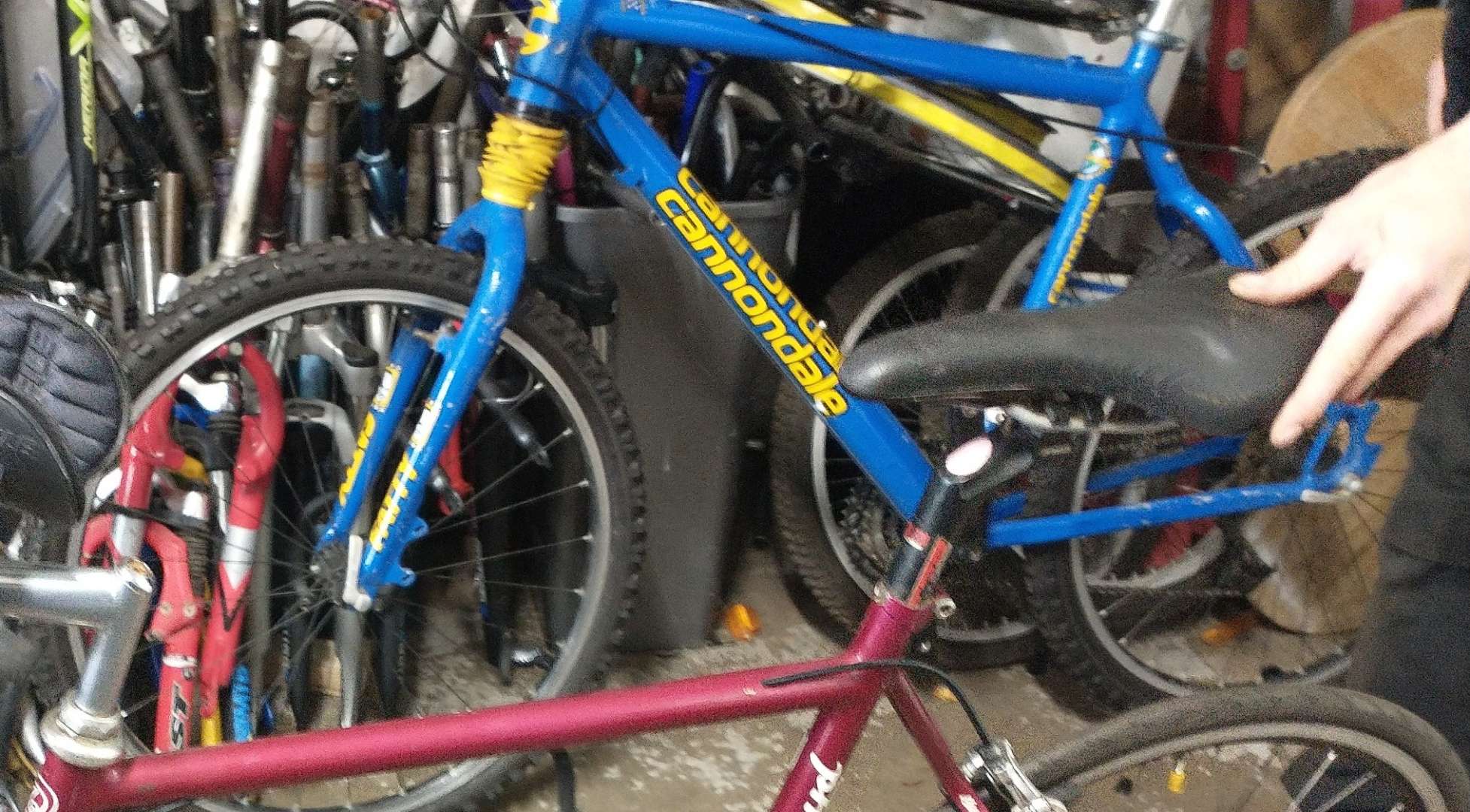

Lurking at the back was a Cannondale cad 3 in Volvo Cannondale blue/ yellow with a headshock and big enough to fit me.
A quick trip to the vice to get the seat post moving and it's mine 😀
The headshock is totally solid and they said they would get it working for £50.

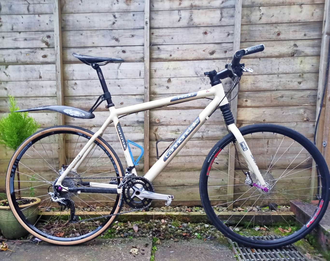

That is a yr2000 F800 with a Fatty DL headshok I think. I've had a lot of cannondales over the years, (series 3.0), CAAD3, CAAD4 and CAAD5. my favourite was the CAAD4, but there'#s not a huge difference in ride feel between that and the CAAD3.
They are direct to pedal, but they are not that harsh IME. You will be limited to about 2.2" tyres, but you can also squeeze a 700 x25c in there, should you want.
My first CAAD frame was a CAAD4 with the fatty SL. like the DL it only had 70mm travel, but it was smooth and well behaved. I actually have a CAAD3 with fatty headshok in my shed unloved that I need to sort out and sell....
the headshoks are, as above, easy enough to get free, but the seals in the damper stiffen and dump their oil, leading to an air sprung pogo. simple enough to fix, if you have the castle tool... I'd love to know what they'll do to get it working for £50.

Posts: 3300
this was the last of my cannondale hardtails (in roadie mode) it did end up with 26" wheels back on it and USE shokpost. (and a matching front tyre)

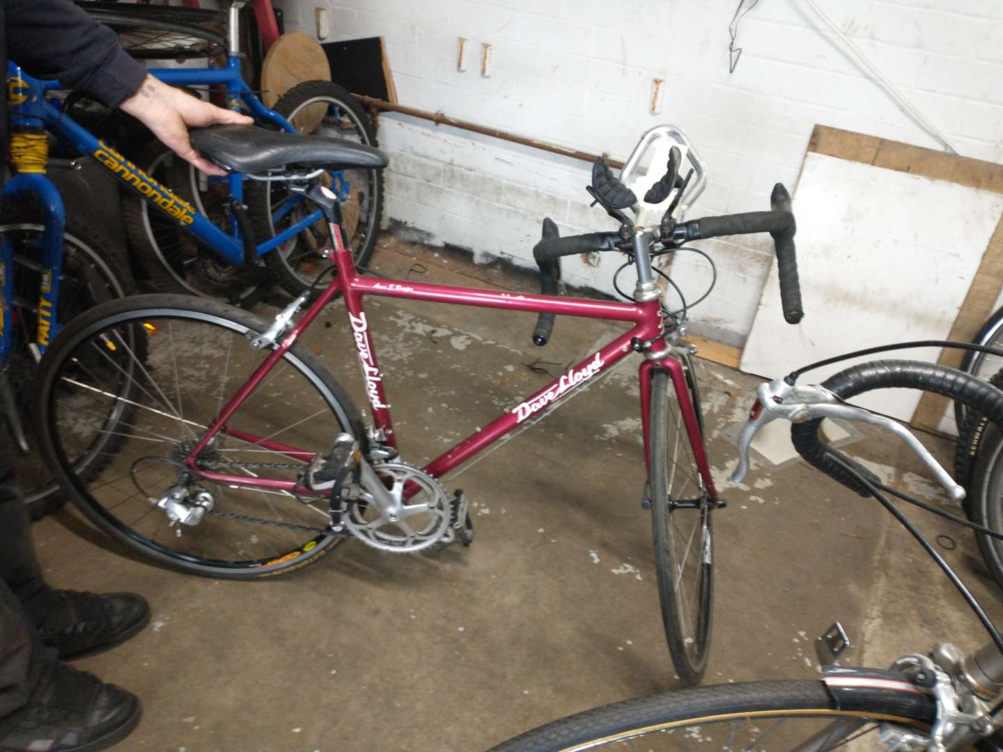

The road bike at the front of the photo looks way more interesting, and I'm not much of a roadie! What looks to be fillet brazed, wishbone stays etc.
Looks like a Dave Lloyd, maybe a Concept 90 with 650c wheels?

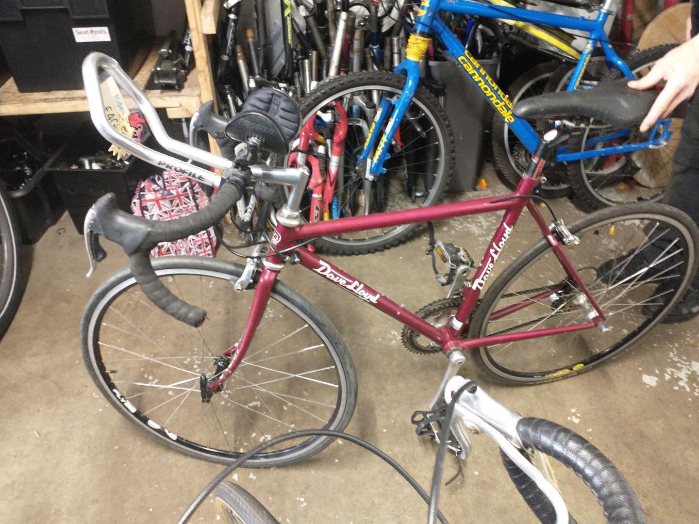

Its a tri bike from a 4 time iron man winner for a bargain. I did have a look but couldn't back up that it had won 4 iron man triathlons. I'm sure there must be some.site like roots and rain for triathlon but I couldn't find it.
I guess it's this lady's as it's got her name on it 😃
https://www.lancashiretelegraph.co.uk/sport/8194333.iron-lady-anne-shows-mettle/
https://m.facebook.com/groups/450550069015417/pos t's/1892403554830054/?view=posts
They were after £200 or £250 for it
There were all kinds of old but shiny things. They seemed keen they went to someone who would use them 😃
Thorn road tandem
Dawes galaxy tandem
A MTB tandem they were putting hydraulic magura brakes on.
Felt a bit like Aladdin's cave

Posts: 2172
Ah yes, Dave Lloyd. I thought the decal looked a bit familiar. Made some cool MTB frames BITD.
