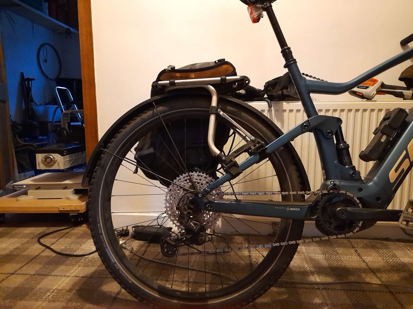

Thule and i think Topeak to racks that attach via straps to the rear triangle.
I've the Thule pack 'n' pedal rack which i fitted to a full suss.
pic -
