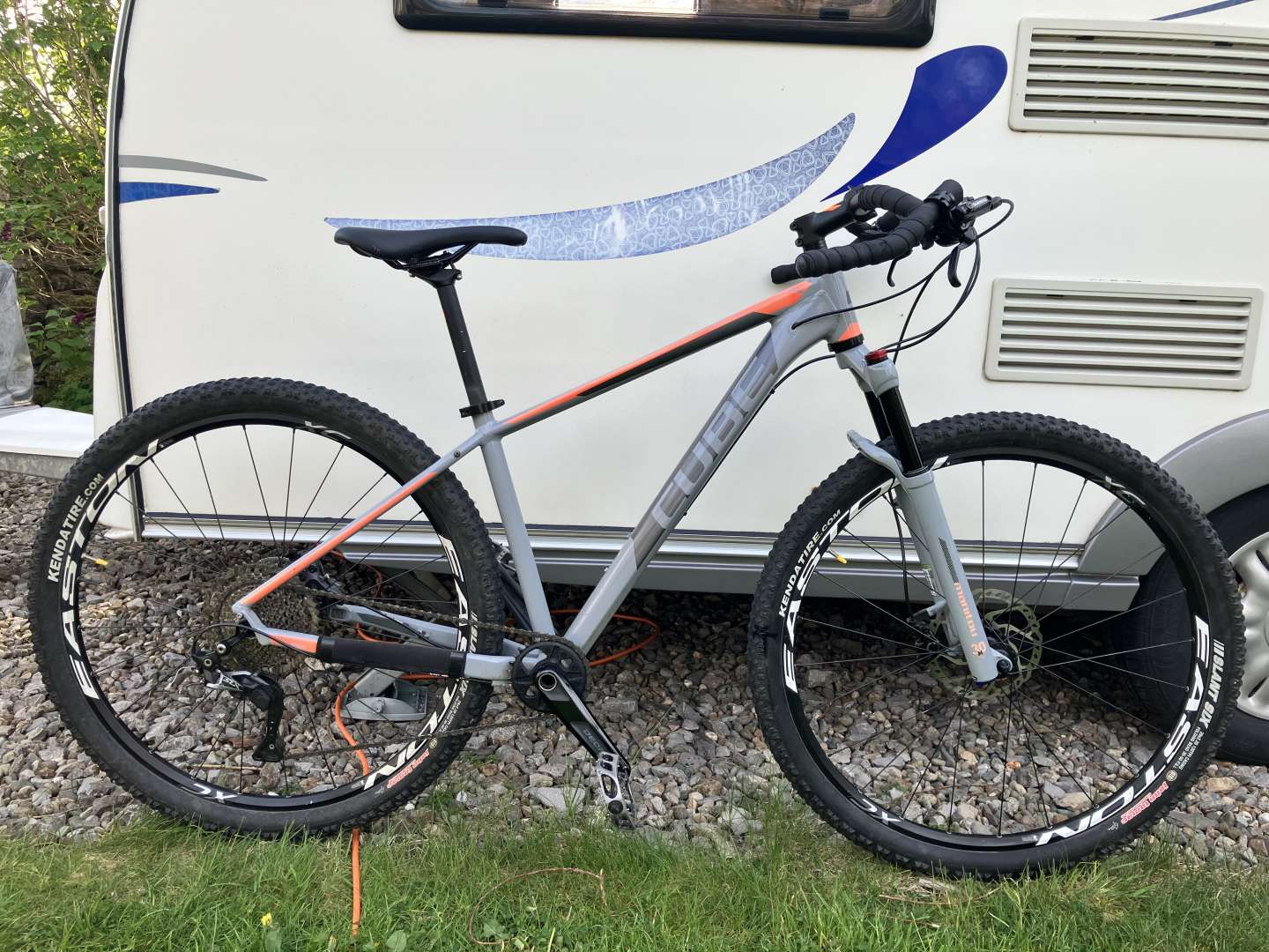

Corner bars would be an easy solution
Privateers are generally quite small so sizing up is usually best but probably not an option if you already have it.
I used this 29er for a couple of years
