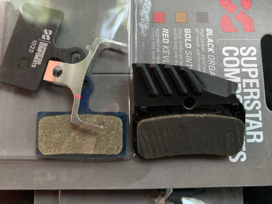

I’m a rush I ordered some S4 pads from them as quick glance it said new SLX.
Turns out these are not the right pads at all. On closer inspection the M7100 don’t look to be listed.
Looking at the picture guide they might be H4 but hard to tell from the guide pics.
Anyone using them and know what which ones fit? Sent a message to them but might get a quicker reply here.

I would have thought S4 (Saint), but just realised that's what you've already got, so slightly confused. I thought all Shimano 4-pot pads were "saint" fit?
Are you sure your brakes are 4-pot? Wouldn't that make them M7120 not M7100?

I think the S4’s should fit most shimano 4 pots or certainly the more modern ones. Saint, Zee, SLX 4 pot( 7120)deore 4 pot (6120) XT 4 pot (8120) all use the same.
So I’m guessing either they have sent the wrong pads or you have 2 pot (7100).

And H4 are for hope.
I would guess if it’s that shape you need S5.

Ahh just checked and pretty much sure I got sent S5 and not S4. That would be why they are different.

Yep those are s5. Email them - they've been really quick to sort issues for me previously.
