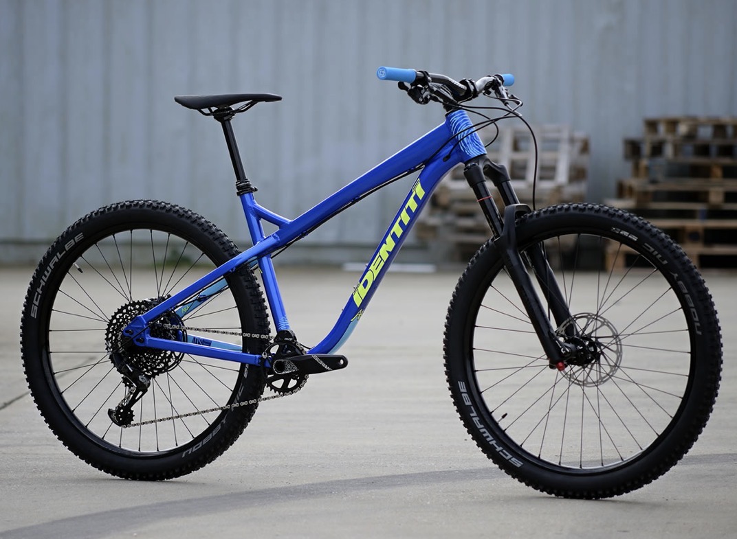

Identiti aka would be cheap and decent. A medium on ebay for not much. Get some plumbers freeze spray and blast that in the seattube from the bottle bosses mount and you can usually crack free the seatpost. You would get an ok amount for a bigwig second hand with that done.

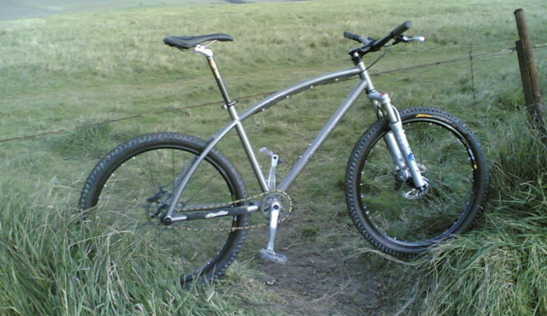

Very happy with my On-One Huntsman, but they don't sell them anymore (Seems a shame that on-one don't have a sliding dropout bike in their line up). I got mine from ebay pretty much brand new. There is a nice custom sirius frame on pinkbike which I was tempted by but the 142mm rear spacing would've meant buying another rear wheel and the fact it is a pre-production one and I had a pre-production Ti Pipedream Modro back in 2005 and it was a bit of a PITA so I think I'm always a bit wary of that.

This thread got me searching for a picture of the Modro. The EBB was completely useless and took up zero slack in the chain. This was the first ride out on it. Had to buy a half link in the end. IMG_1312.jpeg

thats is the worst promo photo of a bike ive ever seen. What use is that?

🤣 ... I thought that too!

I am not a photographer but as a layman I do tend to prefer promo pictures that actually show the bike 😂
