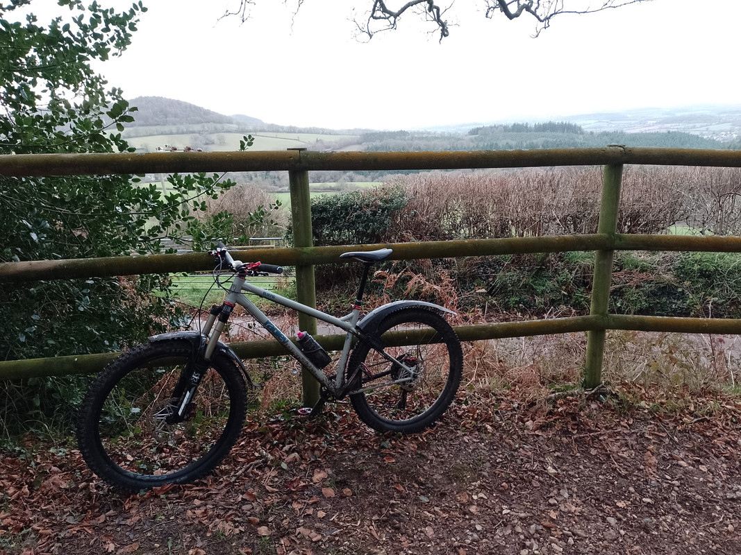

Recommend what ya got....PP Shan?
Mine in 26" flavour
Bought the frame for a couple of hundred s/h, transferred a load of bits from my old Enduro and added a few new bits
[url= https://live.staticflickr.com/65535/52638220929_a62eb33e18_3k.jp g" target="_blank">https://live.staticflickr.com/65535/52638220929_a62eb33e18_3k.jp g"/> [/img][/url][url= https://www.flickr.com/gp/85252658@N05/282zgqJwFC ]2023-01-20_07-31-40~2[/url] by [url= https://www.flickr.com/photos/85252658@N05/ ]davetheblade[/url], on Flickr
