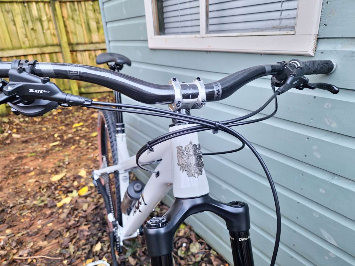

Posts: 14293
Posted by: Ambrose
I see quite a few bikes with what I consider to be overly long hoses that clutter the cockpit, possibly the result of installing pre-bled brakes.
This bugs me, people show off their pride and joy and I look at the hoses and shudder.
I have a bit of OCD about my cables/hoses
OP, I'll measure some of mine when I go in the shed later

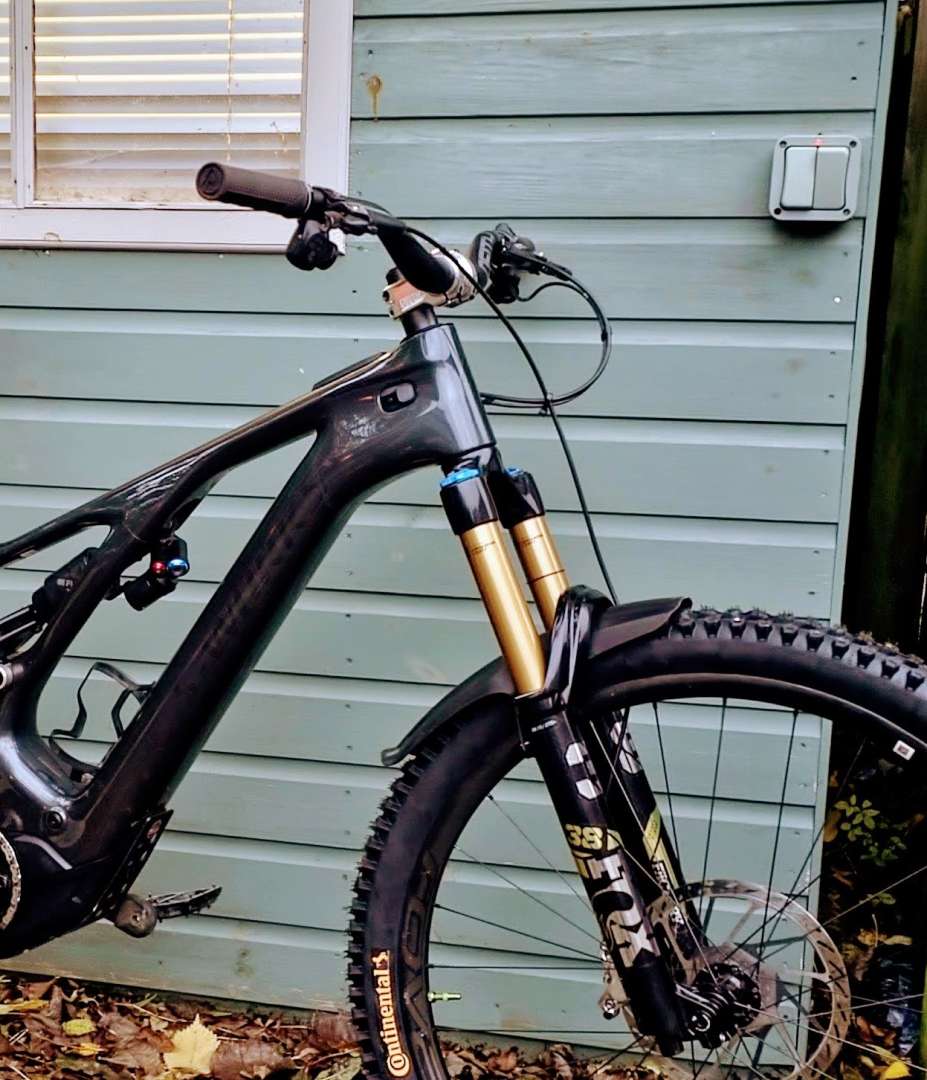

Posts: 14293
Posted by: ajantom
I'd always err on leaving a bit extra lengthwise on the hose for future fettling.
My Levo obviously came shipped with a US brake set up, seeing as the rear hose enters the frame on the wrong side. Which annoys the hell out of me.
When the shop swapped the front to the right side it made it just about long enough. Them me switching from 780mm 30mm bars to 800mm 50mm, it's not the best aesthetically. I may sort it all at some point because I don't like looking at it. 😖
