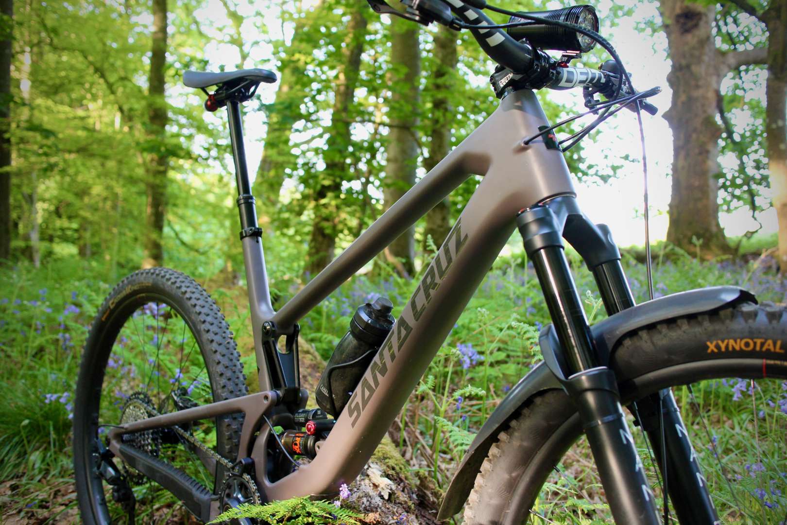

Saying that, I've got a robust build on my Tallboy 5 and it's immense fun and belies the 140 / 120 travel. Factory DPX2 shock and Mezzer Pro might be overkill but the bike works well with them. 15.1kg XXL CC frame, inc pedals, mudhugger, etc but can clearly be built lighter with a more typical build and in a non-gargantuan size.2025-05-13 Santa Cruz Tallboy 5 00007.jpeg
