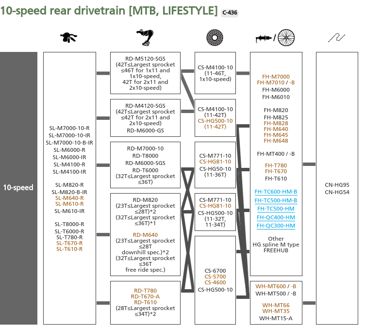

Dont shimano make a 10speed derailleur to work with their 10speed cassettes?
Which 10speed cassette and derailleur? Eg both m8000 and m786 sgs long cage have a max low gear of 36t and a capacity of 47t, but a deore 10s cassette goes up to 46t and won't work.
You need an m41 series mech for that. I've a nagging suspicion that the 41 series isn't the same cable pull as other 10s groups either but it is only a nag, I can't find anything to back it up.

Just found this https://www.rotorburn.com/forums/index.php?threads/difference-between-m5100-and-m5120-rear-derailleur.319884/
5120 can go up to 46t in a 1x10 setup or 42t in 2x10/11
5100 is stated as capable of 51t in 1x only
5100 is 11sp only. If you're keeping everything else the same just get the M5120 and it should be reet...

Posts: 1301
so i have the m5100 rear mech, but only can find 8 gears
Its the 10speed M610 shifter, is the cable pull the same as the M6000?
I get 10 shifter gears/clicks with the cable undone, but connected the derailleur moves the correct distance from 1-10, but only 8 clicks. So I lost 2 gears somewhere
I havent put the chain on yet
Posted : 07/10/2023 4:14 pm
Posts: 6581
Firstly, you should have 9 clicks, not 10
Secondly, why have you bought the 5100 mech and not the 5120? Making things work is so much easier when you buy compatible components as per the Shimano compatibility charts.
https://productinfo.shimano.com/#/com?acid=C-436&cid=C-432
Screenshot 2023-10-07 16.42.31
Posted : 07/10/2023 4:43 pm
Posts: 1301
i shouldve said,if i click it until 8th gear, its level with the biggest cog and wont click anymore
As above m5100 has no logical explanation for not being 10speed compatible, despite not being on the above chart
Is it possible that my m610 shifter is b******d and will slip 2 gears under tension?
This has become purely another exercise in frustration
Posted : 07/10/2023 4:55 pm
Your high and low stops will need adjusting.
At this stage I'd say take it to a bike shop and let someone who knows what they're doing handle the job.
Posted : 07/10/2023 4:59 pm
Posts: 1301
I did adjust the stops
I like to think that i know what im doing, especially when it comes to setting gears up.
Although my memory isnt what it shouldve been
Posted : 07/10/2023 5:10 pm
Posts: 6581
Back the low limit screw off and see if you get the 9th click.
Posted : 07/10/2023 9:58 pm
