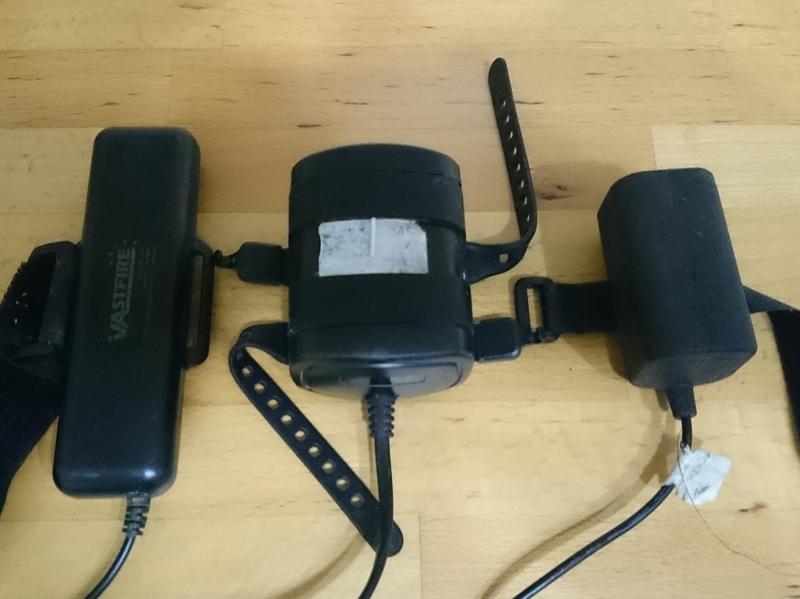

I bought one of these in 10400mAh version (unconfirmed capacity) last year and it's still giving great run time, I like the long shape rather than normal boxy packs, seems robust, haven't found a uk seller but it's cheap enough if you are not in a rush
https://www.ebay.co.uk/itm/8-4V-10400mAh-5200MAH-Rechargeable-Battery-Pack-Waterproof-Fr-Bicycle-Bike-Light/263187918082
We use quite a few lights in our family, having 8 sets. Right hand side is the battery that came with the lights, out of 8 sets I'd say only 3 still work well enough up to 2 hours run time. Some only gave 30 mins from new... (but I like the lights they come with which have been reliable) These were mostly replaced with the 6 cell pack in the middle - run time is still variable, 2-4 hours depending on pack, but much better than the packs the lights came with. The left is the one from the link above, I've not done a full run test but has been 3+ hours. I've got a couple more coming so might do a full test on them all.

Probably not, cells in a sealed pack are more likely to be tabbed not button ends. "Back in the day" when  P7 lamp cost £50 they were pretty good, but when the price and quality dropped then the batteries started to be filled with recycled laptop cells which were already at the end if their life, that's why battery life is so poor.
The advantage of the solarstorm box is you can then buy batteries from a known source, and charge them separately which means they're charged with more control and they're always balanced.
The cost of a charger, cells and box ends up about £50, about the same as a 4cell pack should cost from a reputable source, but should last almost forever in normal use without degrading and won't go out of balance which is what normally kills battery packs.
