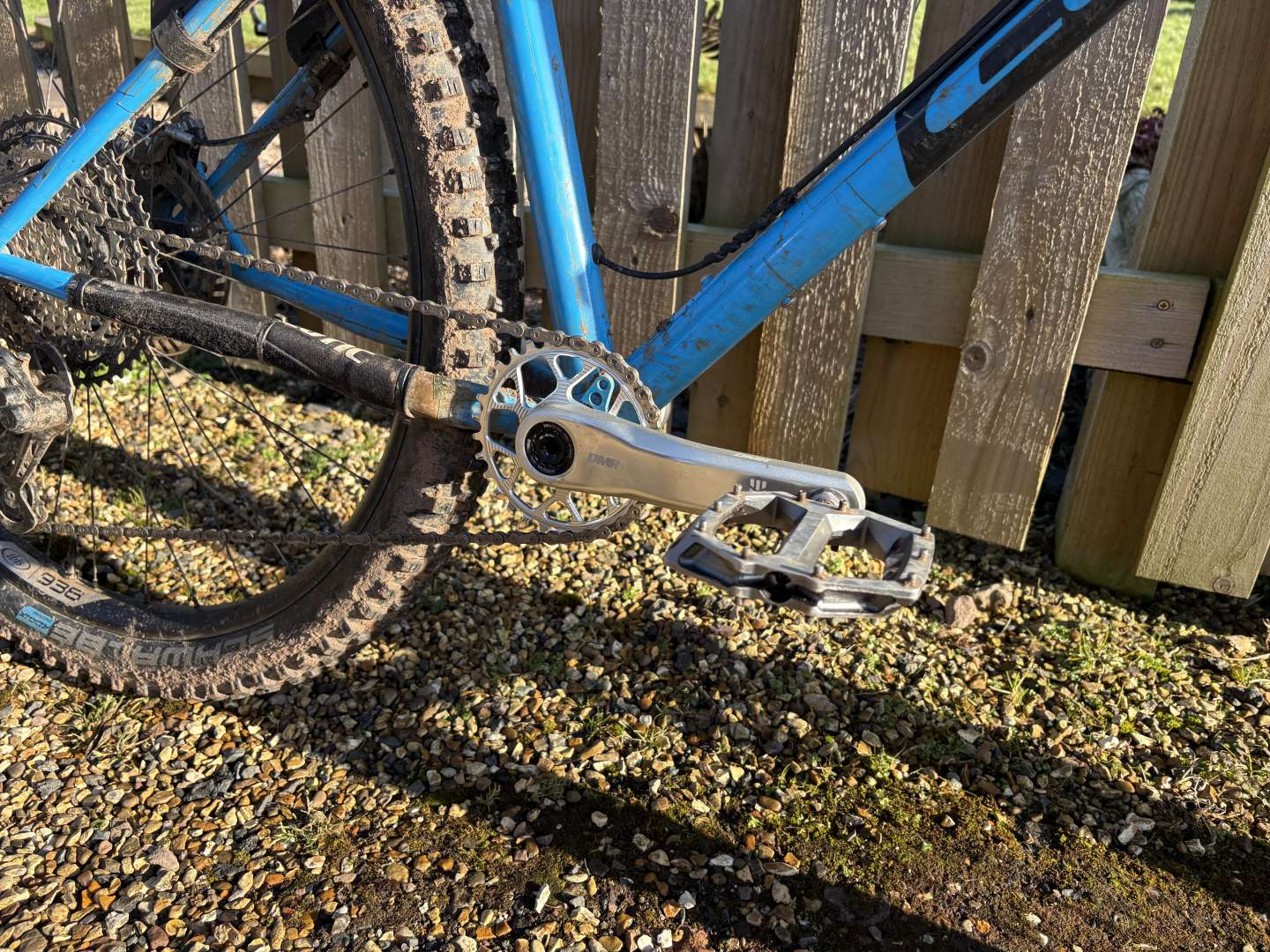

 Alex
Posts: 7447
My mate has the tool and I needed a new BB so I bought some for my HT. On offer so similar price to XT cranks from memory. They did need a good tighten up after one ride, but I really like them.  Mainly as they are silver so not going to show the scuffing like Shimano cranks. They also feel v. stiff.
Posted : 20/06/2025 12:02 pm
 Alex
Posts: 7447
Looking at them now, I have worn most of the "DMR" logo off but otherwise they look very good after a winter of slop. Use a SRAM fitting, that's a works oval on there.

Posts: 462
Posted by: Alex
they do look really good
