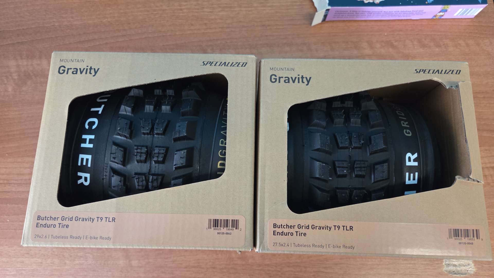

I'm running Butcher Grid Gravity front and rear on the Turbo Levo 22 psi rear 27.5x2.6" and 20 psi front 29x2.6" no inserts. They do feel well damped
The new ones that have just been released have a more aggressive tread than the old ones and my understanding is that the 27.5 will only be available in 2.4
I have never had a problem with the old ones but they wont get me through this years planned trips and although I have spares. Ive just taken delivery this morning of the newer ones as I had some discount codes to use up.
Will fit them ready for our first trip in and give some feedback compared to the others

The XR4 ends up with a very round profile on a 30mm rim which is probably bad for bike park shredding as you'd need a serous lean angle to get the shoulder working but for me, it worked really well. I started at 22psi and dropped bit of pressure here and there. I finished the ride at 19.
With the insert, there's scope for lower pressure if needed. I never felt like I was running the tyre too soft and never felt like I needed to be careful. It was a completely different experience to the XR4 in 2.4.
Ok, it isn't perfect. It's a bit skittish on gravel/ loose stones and was hopeless in the slippy mud but on the rocks that don't move when you hit them, it was miles better.
So, my original question of how much damping is carcass and how much is compound should really have included volume and pressure too as eluded to above.
It's only been one ride but it looks like volume was the answer I was looking for.
