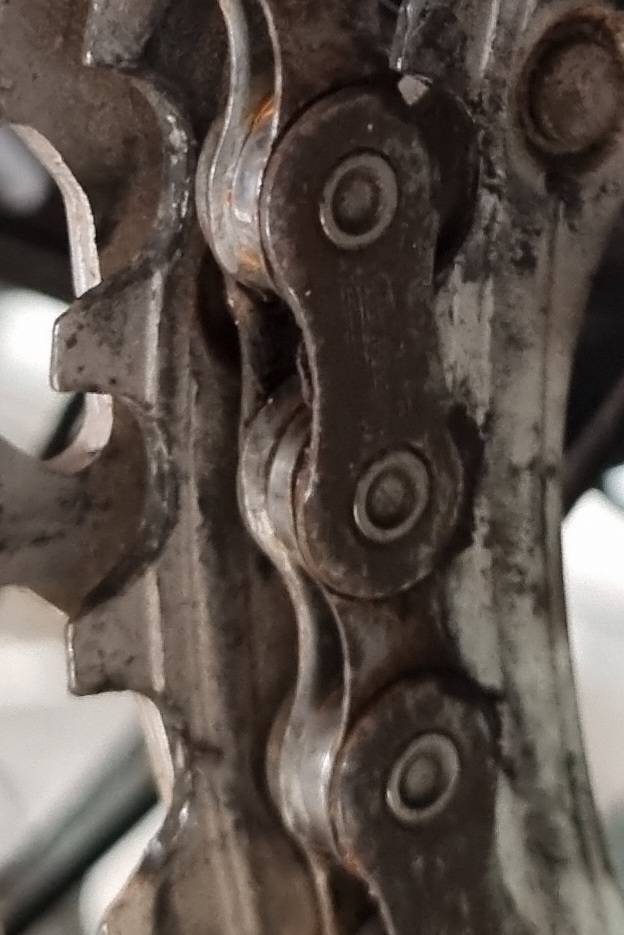

This chain was de-greased when new, then waxed, ridden, wiped, ridden, wiped again then has done a dozen or so rides since. It's been hosed off twice. The rides were dry and dusty except for the last two which were a bit muddy. It's still smooth and silent, remarkably so in fact.

fwiw I'm finding I get about 5-600k before the chain feels like it might need a rewax.  Although maybe this is just me getting nervous with a chain that looks as dry as the one above but probably works ok.  In any case I just take the chain off, wipe off any obvious crap and then shove it in the pan with the wax.
Posted : 14/08/2023 2:02 pm
fwiw I’m finding I get about 5-600k before the chain feels like it might need a rewax. Although maybe this is just me getting nervous with a chain that looks as dry as the one above but probably works ok.
It looks dry but is silent, so it's well lubed on the inside. I go by noise, when I start hearing a bit of chain noise I re-wax.

I noticed a couple of rust spots on one of the rollers on molgrips photo above. I used to get that on mine and while probably harmless it used to annoy me. I then noticed that after hosing the bike down there would be water held by surface tension across the plates. So putting the bike away like that would naturally leave some water trapped between the rollers and the gear teeth leading to rust spots. Now after hosing I wipe the water off with a cloth and then rotate the chain while flicking it along the non tension length to get the water out of the plates. Hardly ever get rust spots anymore.

As for rusting I would only see that if I let the chain sit in the same place after a rinse and more so after winter road rides if it wasn’t thoroughly cleaned. Quick spin of the wheel and up and down the gears before leaving to dry usually solved it. I don’t like it though as I’m assuming there has to be some inside the chain as well.
