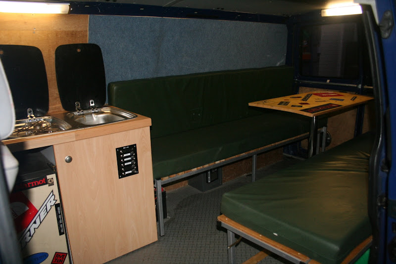

This is my one, sold now... was bloody good for camping with bikes or just driving to somewhere, getting changed inside and setting off.
Click pic for gallery
