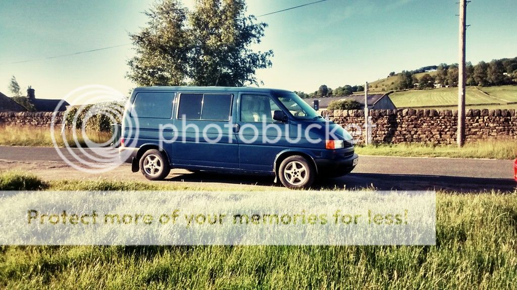

Many of the vans you see for sale with seats in the back started out life as panel vans and have been converted later.
It's difficult to know how well the seats/seatbelts have been fitted.
With this in mind I bought a T4 factory kombi which has factory fitted seats and belts in the back.
Took a while to find what I wanted.
I've made removable single and double bed platforms for occasional van camping.
Here's the single set up.
