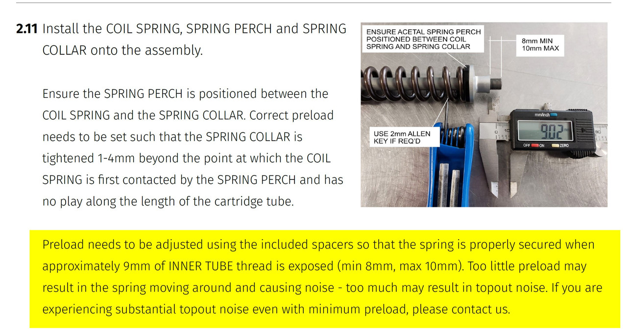

Really easy to install as long as you have the correct tools.
Feels very nice so far but only riding outside of my house - maybe need the 40lb spring instead of the 45lb - There is one issue but I'm not sure whether it's normal or not until I've spoke to TF or Vorsprung tomorrow - there is a noticeable topout knock/noise underlight movement of the fork, this is not noticeable once your full weight is on the bike and you are moving. Slowing the rebound to too slow does not remove the noise but full rebound damping does clear it.
Any ideas greatly received 🙂

How many preload washers have you got on the spring?
Posted : 10/02/2019 6:02 pm
Posts: 223
two x 20mm = 40mm for 170mm travel
Just added the 2mm x 2 to see what happens - it's the same.
Posted : 10/02/2019 6:25 pm
Posts: 17683
You got the 9mm of shaft showing when you fitted the spring?
If it doesn't top out when you're actualy riding is it a problem?
Posted : 10/02/2019 6:32 pm
Posts: 223
9mm showing, not noticeable when riding.
Posted : 10/02/2019 6:42 pm

Posts: 223
So, it's sorted now! Very critical that you do not pre-load the spring at all, just snug the spring collar up to the spring to stop any vertical movement, the spring can move laterally on the collar and spacer but that's not a problem.
Feels very smooth so far but I've only managed a blast round my cul de sac 🙂
Will report again once I've been into Wharny.
Think I may need the 40lb spring not the 45lb I ordered.
Posted : 11/02/2019 8:39 pm

Posts: 223
cheers. I have got one, just not fitted yet!
Before assembling the parts(and covering the shaft with heat shrink) pay particular attention to the preload on the top out spring - make sure the top out spring turns easely, otherwise you'll need to fit a different preload spacer to the top out spring (a kit will be available from TF very soon). In the meantime making sure there's no preload at all on the main spring reduces the noise/clunk to hardly noticeable.
Posted : 18/02/2019 12:19 pm

I was also thinking of resurrecting this thread with a different question - I rushed a spring change recently and my previously silent fork is now clunking. Suspicion is lack of preload (its not a topout clunk) as per the manual - anyone else gone through similar? Easy fix, but better to check before draining the oil and pulling it apart
Posted : 13/07/2022 11:25 am
Posts: 13741
Yes, had this when I swapped springs out once.
Posted : 13/07/2022 4:31 pm
Posts: 6980
Yeah that’s the bit I’ve been looking at too. I’m now on 10mm so time for another washer. A tad annoying that the want you to put the spacer in at the bottom
Posted : 13/07/2022 4:38 pm
Posts: 17683
No need to drain the oil to adjust the preload.
Just undo the topcap and compress the fork then adjust.
Mine came back from having an Andreani piston fitted and had a pretty bad clunk/rattle.
Tried altering the preload with no luck.
On closer inspection the heatshrink had wound it's way up the spring.
Re fitted some new stuff further down the spring and now it's silent again.
Edit.
Just seen your new post.
Unless you can get the big spacer out somehow you will have to drain the oil and take the assembly out.
Posted : 13/07/2022 4:41 pm
