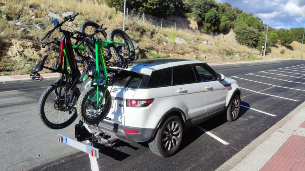

Does anyone do anything like this in the UK?
Scorpion is only two bikes and not available these days, Yakima is receiver not towball.
I’m interested in a four bike one.
Or alternatively does anyone in Spain know anything about these people?
https://mrtbikes.com/portabicis-vertical-bikes/

Light board below bike wheels.
IMG_0672
Four bikes in this shot, though I don’t think I’d lean it this far forward (you can vary that)
IMG_0674

The Vertical Bikes one meets the EU rules apparently
Consider how it very clearly blocks the number plate if there's a bike on there and it's viewed from any elevated position, I strongly suspect it doesn't or that it' at least skirting very close to them.
That said, most bike racks break at least one aspect of the rules, you could drive around with one for years and have no grief but it only takes one Police officer who knows the rules and whose wife just ran off with a cyclist...

The vertical racks are not really UK friendly as we have different rules to the US, it's why you just don't see them here. The requirement for a lighting board renders the design pointless compared to the horizontal ones we're all familiar with. Even that white Evoque above is not legal for the UK, the light board needs to be the rearmost part of the rack. There were moves to get a vertical design without the need for extra lights and number plate EU (and hence UK) compliant back around 2010 but no-one managed it, not even Thule. The odd one on the market now only exist as they exploit a small ambiguity that also allows those high mount strap-on carriers that are meant to leave the lights and number plate uncovered: they put a disclaimer on the box that a lighting board may be necessary depending upon the car. The ambiguity comes in that our laws state that anything overhanging the rear of a car by 50cm or more needs additional lighting so pretty much every bike would be too tall when mounted vertically.
There's also the issue of our towballs being designed for things to pivot as opposed to the 2" hitch the US use. Like benpinnick days they need to be done up stupidly tight to stop them moving with the height and leverage vertical bikes can cause. Remember that the longer the lever the more force is applied.
Posted : 16/10/2023 3:06 pm
On that basis my Thule 4 bike rack wouldn’t be legal.
And on pivoting, a towball is designed to have minimal vertical pivoting, which is why you can put the rack on step back, offer it up, then clamp it. There is some vertical movement but most of the pivoting is horizontal.
I agree there is more leverage at the front wheel but less force applied at that point.  Torque is probably key, force times distance?
The centre of gravity of a flat four bike is 70cm or so behind the ball. That’s a lot of force & leverage even in comparison to the top of the vertical ones.
I may of course be wrong. Been wrong before
