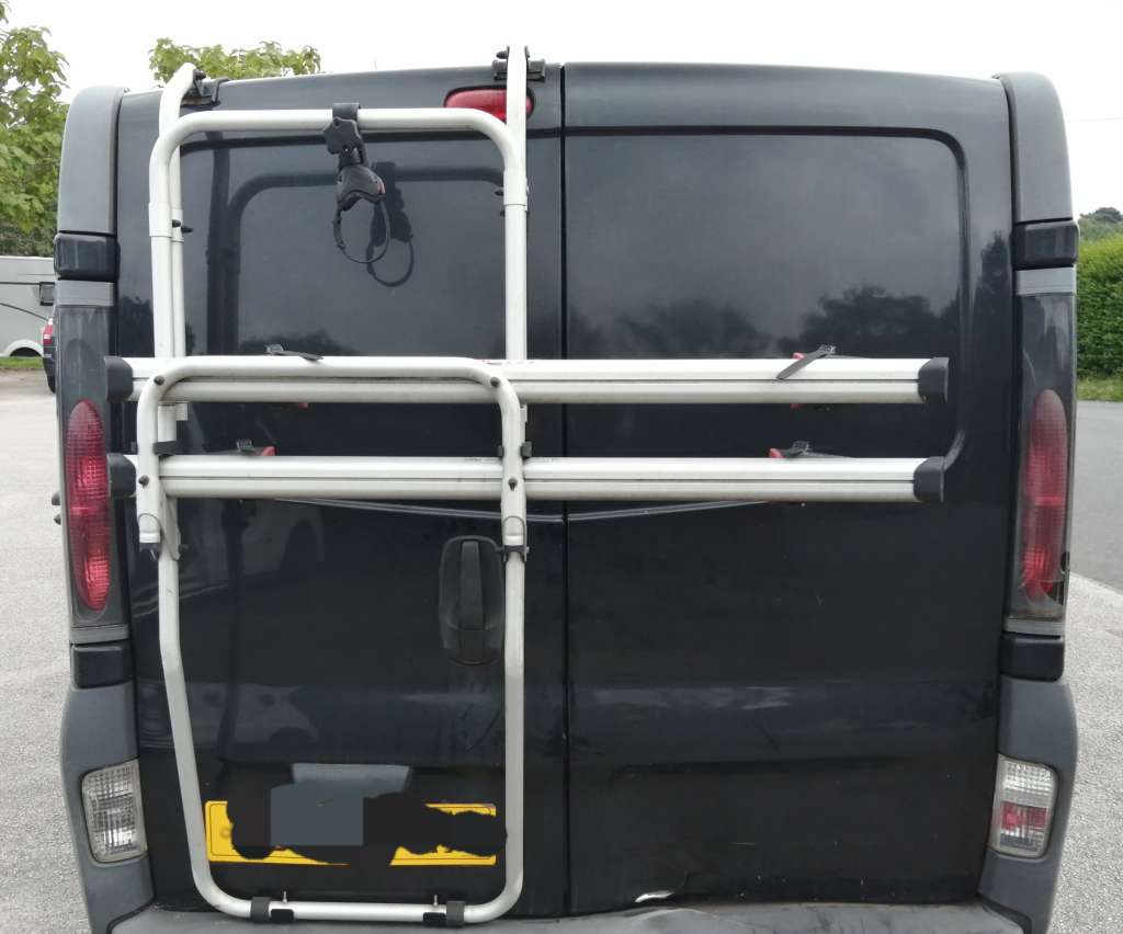

I have this on my trafic. Carries two bikes and doors can be.opened with bikes in place
IMG_20240713_155750
Posted : 12/01/2025 7:40 pm
sboardman, weeksy, kelvin and 5 people reacted
It says it's for H3 only but that seems a bit restrictive, could be worth a call to see if it's just because it's got to be higher to not obscure lights (in which case some trailer light units mounted higher up might get round it?)
https://www.agentfiamma.co.uk/fiamma-carry-bike-200-d.html

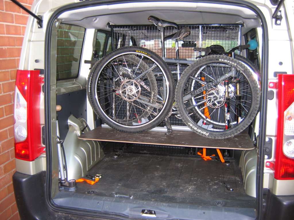

We used to carry bikes widthways in the rear of a previous shape Dispatch. 29ers would fit with the front wheel out (this was pre really long frames, but if your hoses / cables allow the bars and fork to rotate 180 deg then that might shortens things). We used to have them on a shelf to allow storage underneath and lift them to the wider bit over the arches (probably not needed if in the middle away from the arches).
I've just checked our current shape Dispatch and it is 1.6m inside between the sliding side doors (crew van with door trim so a panel van might be a smidge wider). You have lots of height to play with so it might work rear wheel on floor, front wheel out and a raised mount for the fork (with storage underneath accessible from one side door).

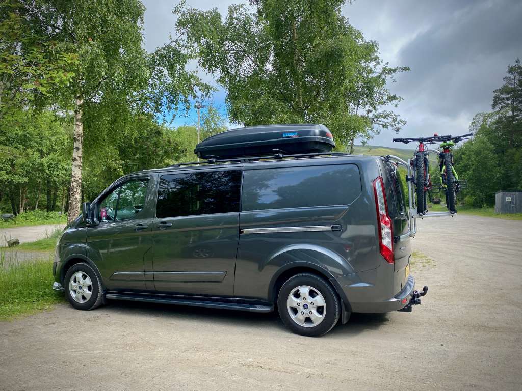

Finding a van with tailgate rather than barn doors (not easy, I know) opens up more options usually. Fiamma 3-bike rack on our Transit Custom with tailgate - I'd rather not use it but at times it's useful, especially with limited cargo area due to being a double-cab in our case.
Edit: add to what DBW says, something mounted to rear door(s) preferable over a towbar rack IME. Most/all are high enough to clear the lights/numberplate, plus no storage issues when not in use: it's always just there.
