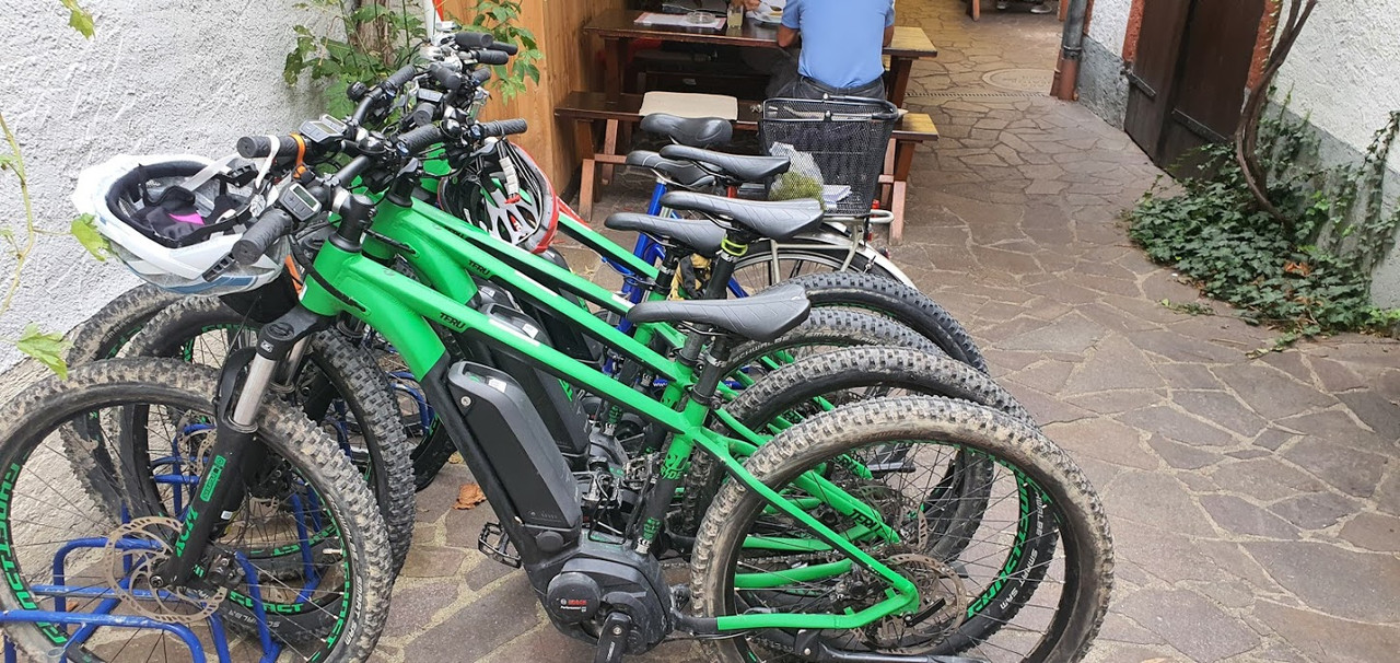

Right, I will be buying 20 hardtail ebikes to do bike tours. The idea is that I will be providing custom tours all over Austria. One day it might be Vienna, next might be Salzkammergut, next day Kitzbuhel and so on. I want to be able to bring the bikes direct to the start of the tour and offer a full customisation package - organise and lead tours wherever they are needed.
In order to do this I need a van. With that in mind what would you guys recommend as a bike delivery vehicle? Which van would you recommend to carry 20 ebikes. I would rather not have a trailer as I might have to be parked overnight on the street and don't want to risk it to have the bikes in full view.
The bikes I'm getting are Ghost Teru. Here's the demo ones I took out the other day.
