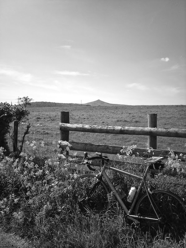

This is probably why gravel bikes exist
But nonetheless...
When your only tool is a hammer, everything is a nail
[url= https://live.staticflickr.com/65535/48781121731_6e1e09e5e3_o.jp g" target="_blank">https://live.staticflickr.com/65535/48781121731_6e1e09e5e3_o.jp g"/> [/img][/url]
[url= https://live.staticflickr.com/65535/48780755408_7008dfb332_o.jp g" target="_blank">https://live.staticflickr.com/65535/48780755408_7008dfb332_o.jp g"/> [/img][/url]
[url= https://live.staticflickr.com/65535/48741403281_a7ace0c887_o.jp g" target="_blank">https://live.staticflickr.com/65535/48741403281_a7ace0c887_o.jp g"/> [/img][/url]
(In Oz a few months back and the only bike I had was a Giant Bowery. Did manage to squeeze 28mm tyres in for a bit of luxury though. 🙂 )
Posted : 14/05/2020 12:48 am
NVM
Posted : 14/05/2020 1:06 am
Proper vertical terrain too! 😉
