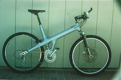

It started life as a conventional upside down fork called the moto that Cannondale engineers massively overbuilt for DH racing, They quickly realised that it was stiff enough to remove one side, lo and behold the lefty was born.
is this true? I've heard it before, didn't know if it was a rumour. If it is it could be seen as quite a damning point on the viability of UD forks really.
no
the original moto was a conventional UD fork, circular legs, and glide bushings, and weighed a ton.
Then came the twin legged, right-side up moto forks, with needle bearings like the headshok, but they really did weigh a ton
(and I believe there was a UD needle moto in there briefly but not sure if they ever made it to non-team use)
The lefty was actually born from the desire to create a longer travel version of the headshok, (running octagonal peg in octagonal hole with 4 sets of needle bearings) without the weight of the needle moto , but there not being enough room in the headtube to house the amount of gubbins for the the travel.
They then realised they could shift the telescope sideways, with an upside down design, make the axle bigger and maintain stiffness while reducing the weight... hence the lefty.
*As told to me by Cannondale mechanic some time circa 2000
