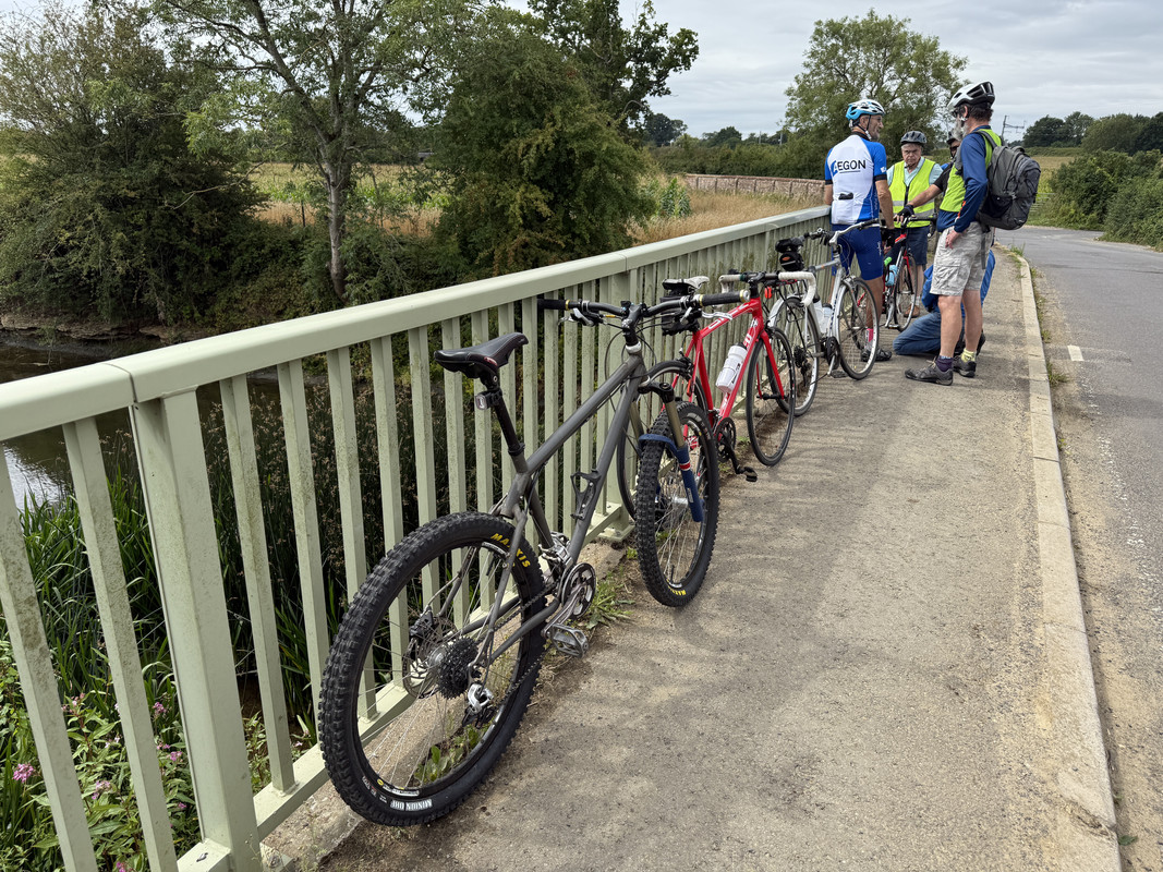

I’ve got an old On-One hardtail with Hope hubs, that has just the middle ring and granny and the 9-speed cassette from when it was originally built up from various parts about twenty years or so ago. For sheer simplicity’s sake, would it be possible to put one of the newer wide-range 11/12 speed cassettes on the existing Hope hub, with a newer rear mech, replacing the SRAM X-9 it’s currently running?
Not sure if these pics will help at all…

The bike is all SRAM - I don’t use Shimano. Basically, I want a single ring on the front, so I can ditch the whole front mech/shifter, and have the widest range rear cassette and whatever SRAM mech and shifter I can fit using the Hope hub and rear wheel.
To repeat, I’m not using Shimano, I stopped using Shimano twenty years ago, and I’ve been perfectly happy with the X-9 on the Inbred in the photos, and the X-0 on my Trek Remedy 66, and I mean to carry on using SRAM in whatever way I can to achieve a 1x 10/11/12, the get the widest possible range using a single front ring.
Where I ride, there are lots of long, steep hills, the bike weighs around 15kg, and it’s got 2.3” Maxxis, so not a fast bike! I’m too sodding old to get up off the saddle and power up 1:6 hills; I’m barely avoiding getting off and pushing as it is!
This is an on-going plan, I’ve only had the bike back on the road for two or three months, after it’s been sat in the shed for about twelve years, so I’m well out of touch with everything that’s been going on in the world of cycling!
I also have an Inbred 853 SS, and I’ve got to replace at least one of the Hope M4 callipers, because one of the pistons has seized, and it’s too old to get spares, so I also have to factor in the cost of a new brake, so minimum expense on the Inbred 567 in the photos is the plan, it works ok, I just want to make riding it even simpler with a single shifter and the widest possible gear range.
Posted : 20/09/2025 12:58 am
