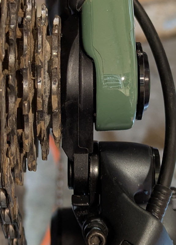

Never thought this would be simple! So have removed uhd compatible mech and replaced with uhd hanger and normal mech. Hope hub and Eagle 12 cassette.
So why, when I do up the axle won’t the wheel spin? There is no space between the 10 tooth and the hanger!
Tightened cassette, took hanger off re-fitted. Can’t see how to make a difference…
What stupidity from me has occurred this time? 😥 Thanks

The wheel hollow axle/end cap should bear against the inside of the UDH/drop out to allow it to spin - does the hub need a different cap to work with UDH?

Transmission cassette?

What's the bike?
I've found that UDH hangers are not all the same... I'm looking at you Santa Cruz!
Maybe take the wheel and UDH hanger off and see how they mesh together off the bike?

It is a T-Type cassette. I have a bog-standard Eagle one… i’ll try that.
bike is Cannondale Moterra sl. Nothing in the documentation suggests it needs a specific hanger, not that I can see.

Brilliant, thanks Kelvin. Turns out t-type cassettes are only compatible with T-type mechs. Well well, its a non stop learning game this messing with bikes 🤯

I didn’t check it, its only about 2mm difference - the non t-type cass sits further in, leaving a bit more end cap. I doubt there’s enough room for a bigger low-gear cog with t-type. I’d guess there’s a slightly different spread on the cogs.

The point of the T-type cassette and rear mech is that the geometry (the gap) between the 'hanger' (I know its called a hanger) and the cassette is fixed - where previously this was entirely depended on how the frame manufacturer had designed their dropouts and bolted on hanger.
