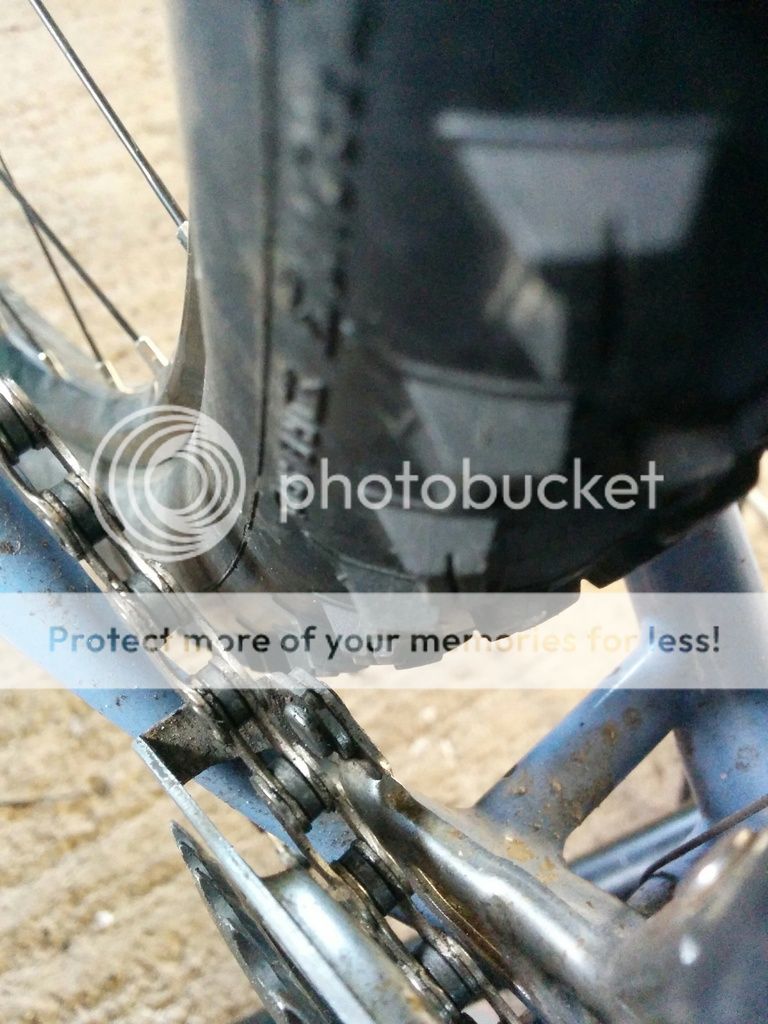

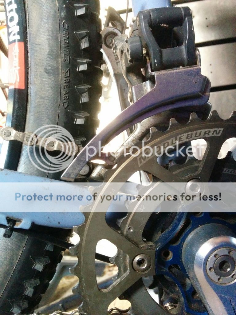

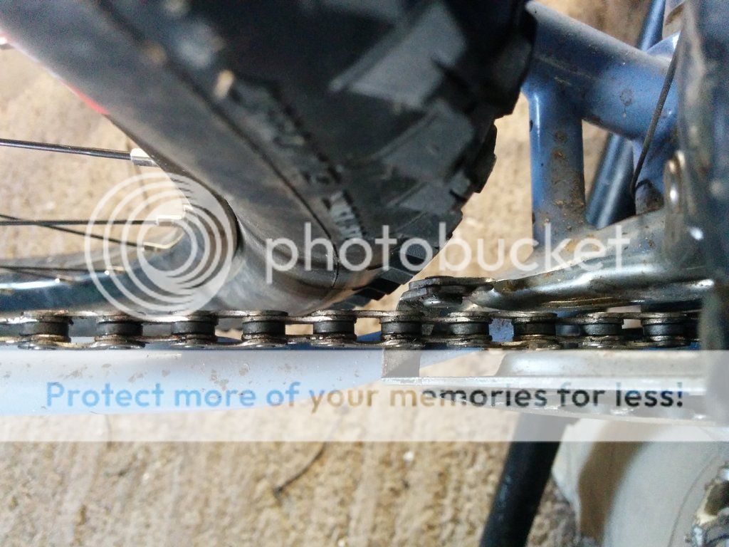

Thanks for all your help, I'd like to keep the triple running if I can, but with 2 mm clearance it doesn't seem sensible. These pics might help explain the issue better:
[IMG] [/IMG][/URL]
[IMG] [/IMG][/URL]
[IMG] [/IMG][/URL]
That can't be right can it? Is it just a rubbish mech or something else? I can move the cranks round a bit because of the EBB but I can't see that it would help...

If you've got clearance it's fine - it'll just act as a mud scraper when you're grinding up something. It's only if it's touching you've got to worry.
(IMHO)
Posted : 22/07/2015 9:12 am
Ditch the front mech unless you live somewhere really hilly. Swift mk1 always had tyre/mech issues, but it was designed as a SS primarily. Put decent wide tyres like those in the pics & it's always going to be close. I run mine 30x12:36 which'll get up most things. With a direct spider you might go 28t but it will be very skinny on the flat
