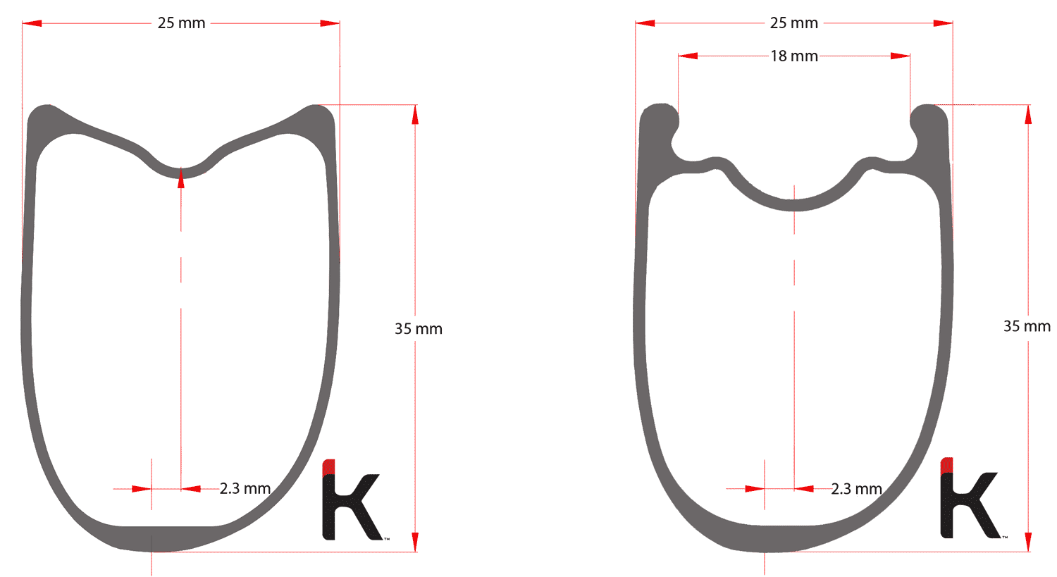

So I'm confused, but tub curious... what are they? What are the advantage over tubeless or indeed a regular tyre & tube setup?

So I’m confused, but tub curious… what are they? What are the advantage over tubeless or indeed a regular tyre & tube setup?
Exactly what they sound like - they are tubular tyres, so rather than being an open shape, a "u" cross section if you like, into which you fit a tube they are a "o" shape, with the tube (which can be latex or butyl as with normal tubes) stitched into a carcass with the tread and everything. Like this:
You have a rim with a slightly concave surface (and no sidewalls) onto which you glue the tyre (or use very sticky double-sided 'tub tape') using tyre cement, a very strong contact adhesive. Rim profiles (tub on the left):
The advantages are:
- lighter rims (with carbon), saving c200g versus equivalent clinchers is common
- stronger rims, no vulnerable sidewalls, just a box profile
- better handling of heat in carbon rims, no brake track failures as it's a structural part of the rim
- better handling when flat - because they're primarily held on by the glue (the air helps) you can ride them flat marginally more successfully than many tubs
- more puncture proof - very few pinch flats
- can handle far higher pressures
The disadvantages are:
- expensive
- a faff (people will debate that, but they are more faff than clinchers), both to fit, to change and to repair
- chance of rolling a tub (much like a blowout on a tubeless tyre, crash all but guaranteed)
For years the principal advantage was a reduced rolling resistance and improved ride quality. However in recent years they've made faster clinchers, and 'ride quality' is hugely subjective. Lots of tub advocates will still say they ride far better, but IME it's far from black and white. It's commonly accepted wisdom these days that outside of the velodrome a wider tyre at lower pressure is better than a 22mm tyre at 180psi.
The pro peleton is overwhelmingly still using tubs, but they've got a car following with spare wheels already fitted. If that's not you, then you need to consider how you feel about carrying a spare tyre (either a very expensive incredibly fragile one, or a bulky thing) and a wooden spoon(!) to fit it, or if you're happy to phone for a lift if it all goes wrong many miles from home. My main concern about using an ultra light spare was that if I've punctured my 'normal' tyres, fitting a crazy light spare would make me very nervous indeed, and I'd be gingerly heading home immediately. Possibly not wholly rational, but it was enough to make me switch back to clinchers.
