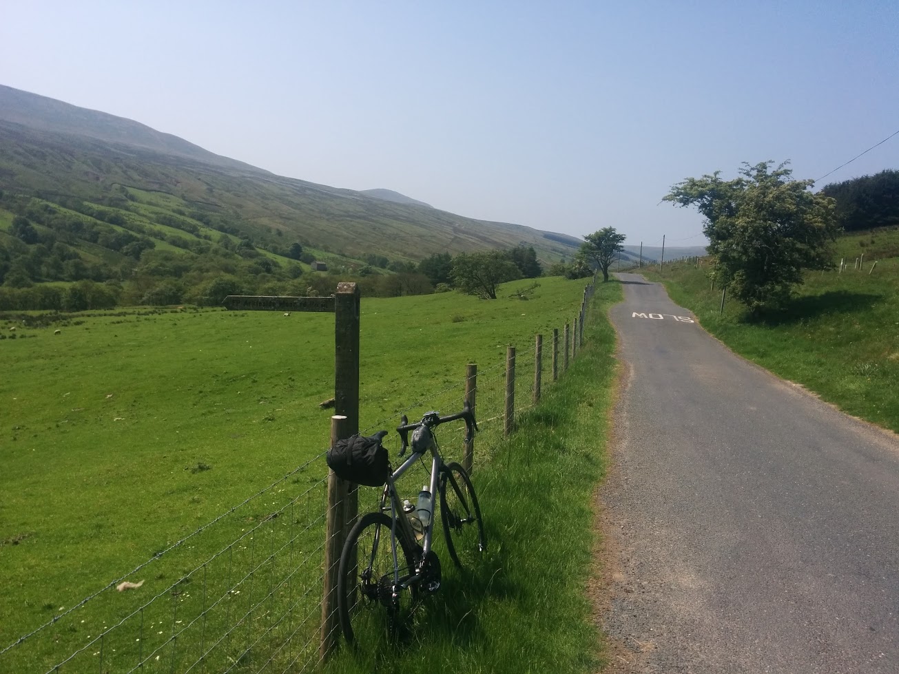

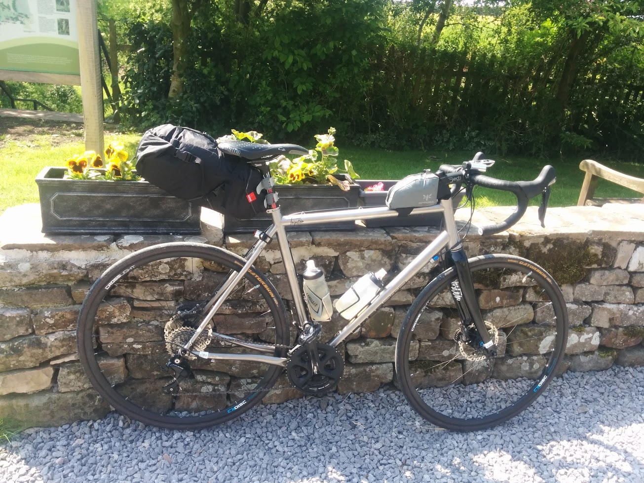

Short bike update. Used my for a trip through West Wales and a tour of the Yorkshire Dales a couple weeks ago, done around 700 miles since I got it.
Its pretty standard - Kinesis wheels, 105 groupset, but I've added shimano hydraulic brakes which are amazing.
I love it, its really comfy and stable and gives me confidence descending. I'll never be a fast rider so it suits my needs perfectly.
@matts - yes mine came with a post mount fork I think they changed it 8-9 months ago
[img] https://goo.gl/M57ixn [/img]
[img] https://goo.gl/pWhFCT [/img]
Posted : 21/06/2016 11:02 am
My pic didn't seem to work, here's another
[url=[url= https://c3.staticflickr.com/8/7383/27820648346_cc5c75b4c0_b.jp g" target="_blank">https://c3.staticflickr.com/8/7383/27820648346_cc5c75b4c0_b.jp g"/> [/img][/url][url= https://flic.kr/p/Joq6uN ]IMG_4324[/url] by [url= https://www.flickr.com/photos/the_pilot/ ]Phil[/url], on Flickr]null

Just prepped the tripster for summer, fitted some mudguards :
[img] ?oh=e1a9c821245ab78ac642f49a33a8ed21&oe=580086F8[/img]
Posted : 03/07/2016 7:16 pm
Posts: 7121
Thanks turnerGuy.. Should guarantee us no rain for the next 4 weeks..
Posted : 03/07/2016 7:20 pm

Pic of my trusty ATR, after the hard, painful but fun Lapierre white-roads-classic-sportive.
[img] ?oh=10996534a4de5bd425e9193d1cf93710&oe=58361E0A[/img]
There was some other nice bikes/set ups there as well.
Posted : 06/07/2016 11:02 pm
