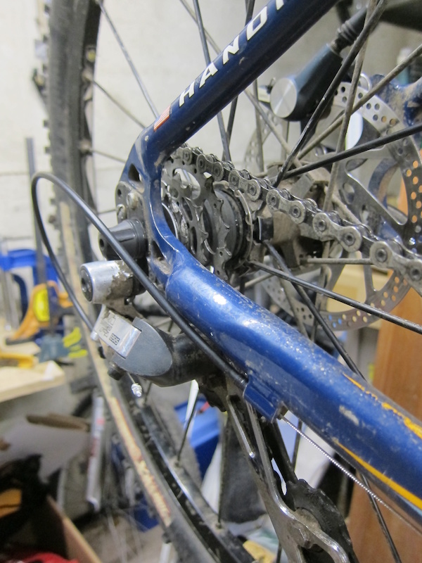

Building up a singlespeed using an old mech as the tensioner, then I thought I might as well add a couple more cogs..
That seemed to work quite well... so I thought it would be nice to be able to change those 3 gears...
Seems to work well - all the way forward on the fork lockout is 21:39,all the way back is 11:39 and is 16:39 is somewhere in the middle.

Or just use a triple crank and SS hub?
Posted : 12/01/2014 8:36 pm
I did think about that as well, although you would still need a tensioning device at the back which would add weight.
This was just from stuff in the spares box.
Posted : 12/01/2014 8:40 pm
Posts: 9306
I'm with Al, if you have a mech, why not have more gears? The weight argument is there but it's not a very strong one. I only have 6 gears at times but that's a Hope SS hub so there's a reason for it. Until the hub bursts into flames I guess..
But I'm impressed by the use of the remote lever to shift gears, that in itself deserves a Useful Bodge Award. And I guess it lets you keep the chain tension / mech position tight.
On a similar line, I borrowed a surly tensioner with the adjustable jockey wheel position to try a 3-spd manual shift. Daft, but the idea was to have a SS-ish remote touring bike with a choice of ratios. The tensioner adjustment should allow the chainline offset to work with less risk of dropped chains. Decided that a thumbie and mech with 3 more cogs was weight I could live with ...

Shirley, you need a 32 or 34 to give you a mire useable range off road? You could also then get the ring on the inside of the spider for (possibly) a better chainline?
Like the idea though - I've done the triple ring, single cog before and it worked a treat...
Posted : 12/01/2014 8:52 pm
Yeah, the 39T unramped chainrings were £7 on CRC, I would have preferred a 36T.
I may have to change the cogs (11 - 18 - 24 maybe) on the back to suit my riding when I've tried it off road.
Chainline seems ok due to the cogs being shifted to the end.
Posted : 12/01/2014 9:01 pm
Wouldn't a tringle speed have 3 cogs at the back and 3 at the front that all use the same length chain like a dinglespeed? What you have there is just a bike with 3 gears!

You save say a hundred grams?
XT cassette = 300g, 3 small cogs = 50g? (250g saving)
XT 9spd Shifter = 125g, fork lockout = 25g? (100g saving)
350g saving being optimistic? 300g saving being Cynical?
75g penalty over pure SS?
