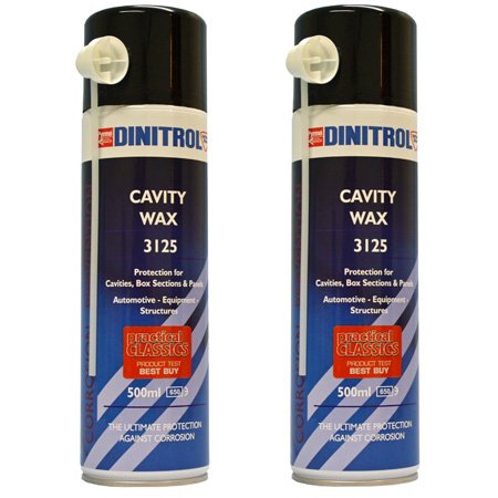

Posts: 1442
Dinitrol. like framesaver only cheaper and in a bigger can.

Posts: 1519
I once used Waxoyl spray. Total waste of time.That Cavity wax looks good though.
