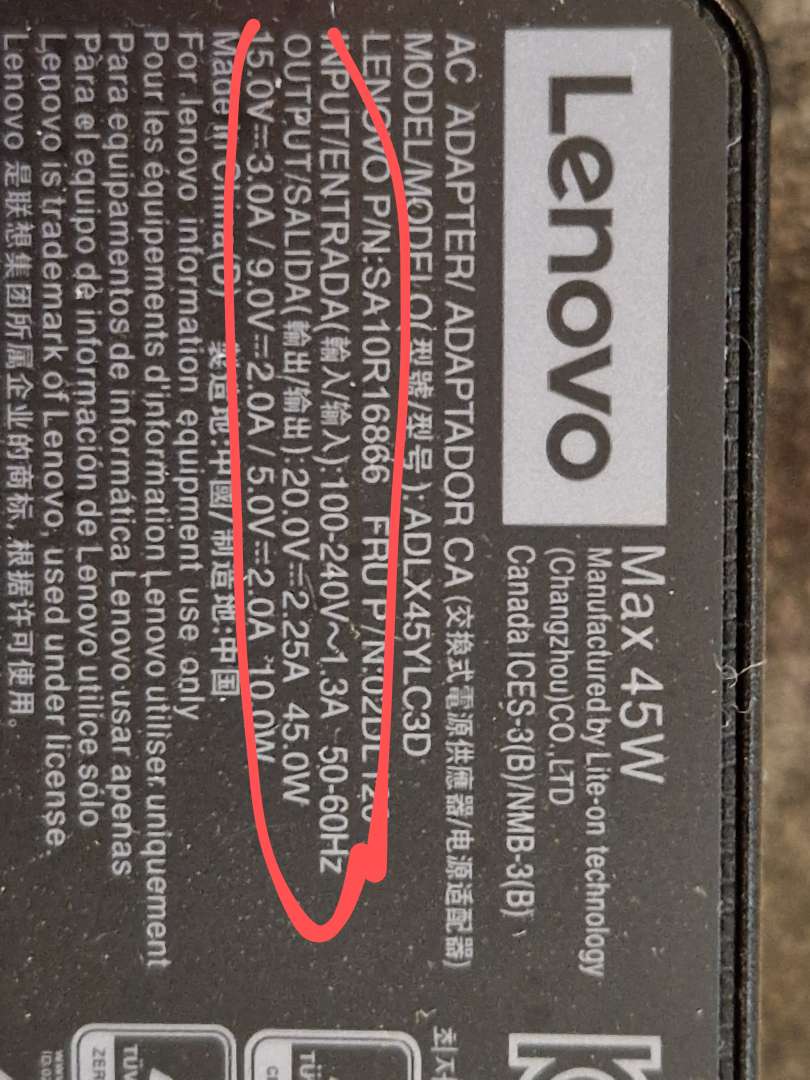

Posts: 11476
It won't normally be written on the charger.  The output watts is not the input watts.
See my laptop charger below, depending on device it states 10w or 45w.
The input is amps x volts i.e 1.3A x 230v = 299 watts, that's the load on the inverter. And it may spike when first plugged in so normal advice for this use would be to get a 500w inverter.
And if you are buying an inverter, cheap ones have a very dirty supply (modified 'stepped' sine wave) that won't run anything with a motor properly (i.e drills) and can also kill sensitive stuff, I killed a couple of toothbrush chargers doing this, and my laptop mouse would not work when charging off a cheap inverter. You'd be sensible to buy a pure sine wave inverter.

Posts: 283
There is no way it's drawing 300w to output 45w. Probably more like 60w.
