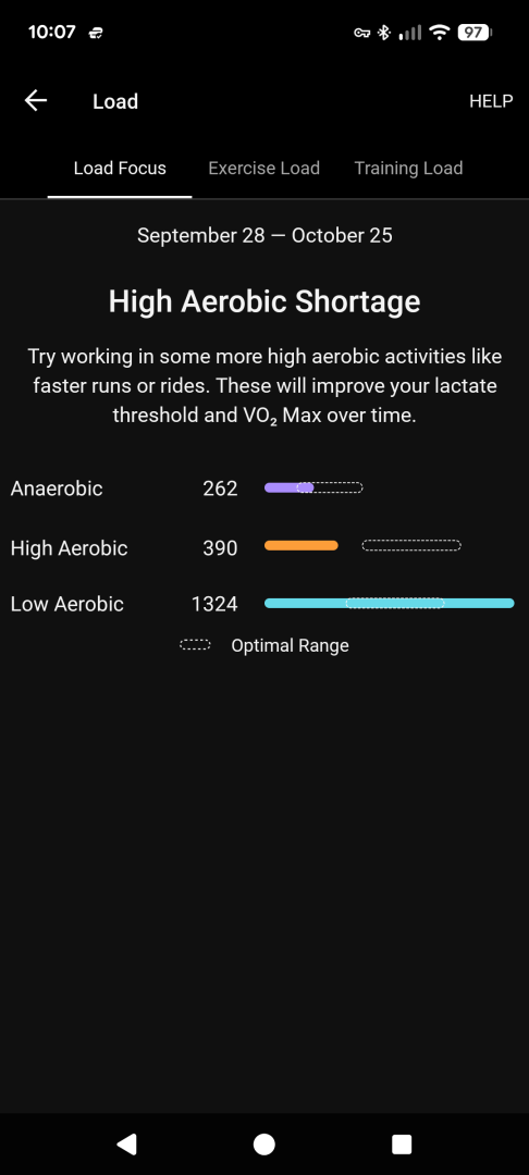

Garmin Connect tells me that my "training*" is lacking in High Aerobic activity.
A bit of Googling suggests some riding at fairly tight power zones (eg 2x 20 mins @ 80-85% of FTP) would help.

It's straightforward to go out really bloody hard and get Anaerobic points. And it's easy to go easy and get Low Aerobic points, but I'm mystified about what I should be doing for High Aerobic points (past VO2 sessions haven't added point to the High Aerobic total 🤷)
Though I'm somewhat skeptical of Garmin's algorithm because these numbers seem to be randomly generated - after my last turbo session using Garmin's own Training app), the only change to these numbers was my Low Aerobic points went down (from 1401 to 1324)!
