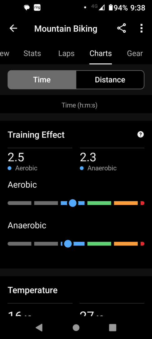

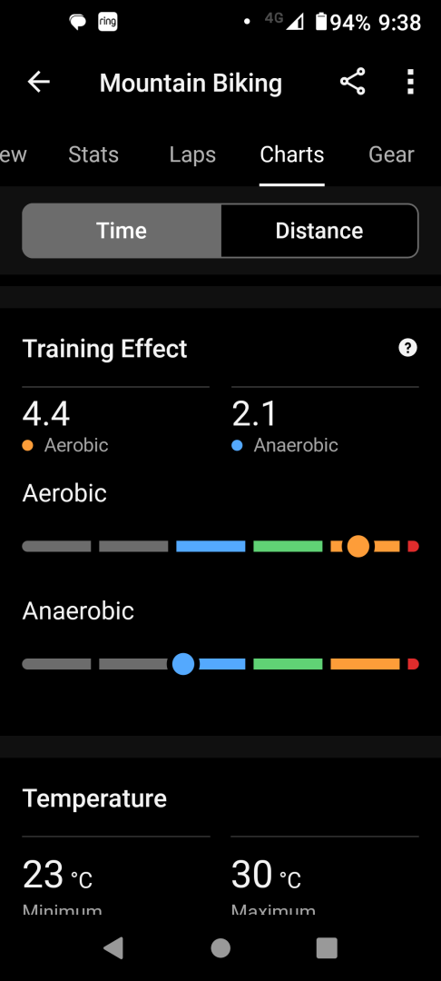

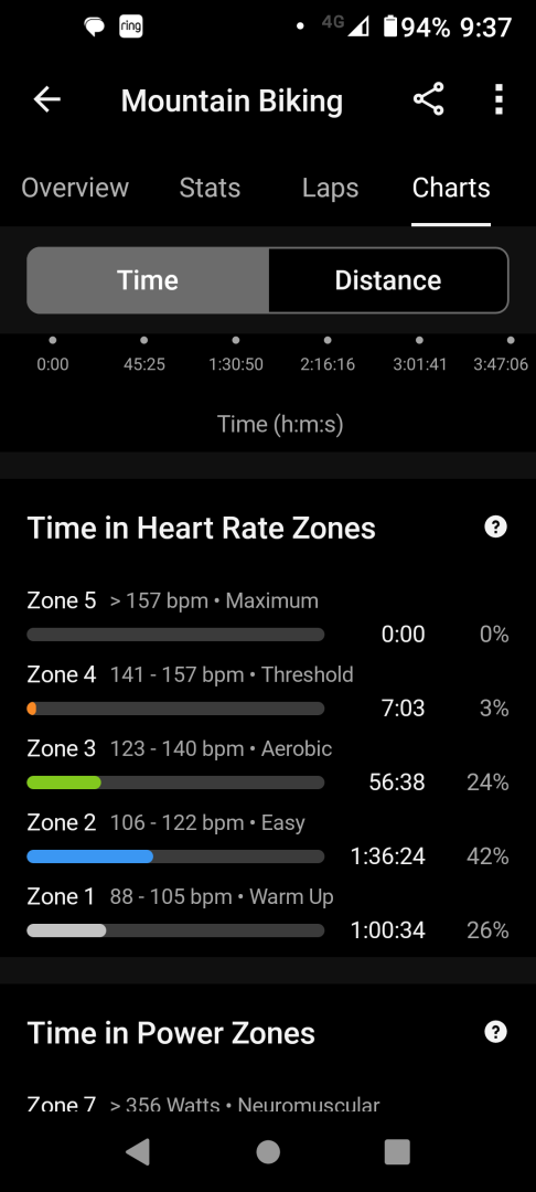

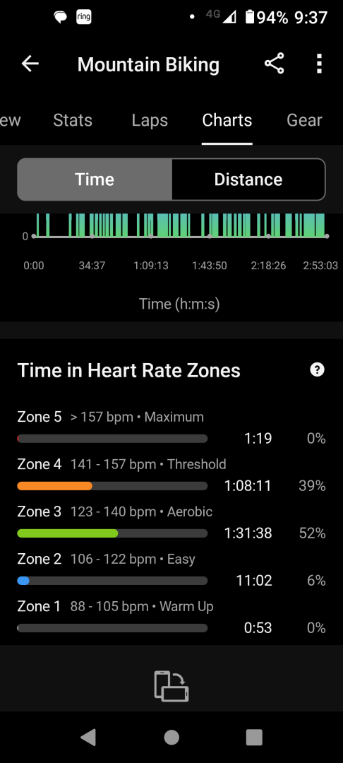

I'm not sure how accurate the power meter on my eBike is, but I also have a HR monitoring watch which is roughly accurate, so one day if I remember I might try the climb twice with and without assist to see what Garmin stats tell me from all that data.

This is a typical local ride for me at current fitness levels.
If I was at peak (for me) fitness, I'd make myself work harder on the ebike though
Screenshot_20250502_092406_Strava.jpgScreenshot_20250502_092347_Strava.jpgScreenshot_20250502_092320_Strava.jpg
Posted : 02/05/2025 8:26 am
Posts: 17683
Manual against eeber.
Screenshot_20250502-093812.pngScreenshot_20250502-093743.pngScreenshot_20250502-093839.pngScreenshot_20250502-093710.png
First two are manual.
Eeber seems great for recovery rides.
Not so great for getting fitter.
Posted : 02/05/2025 8:46 am
