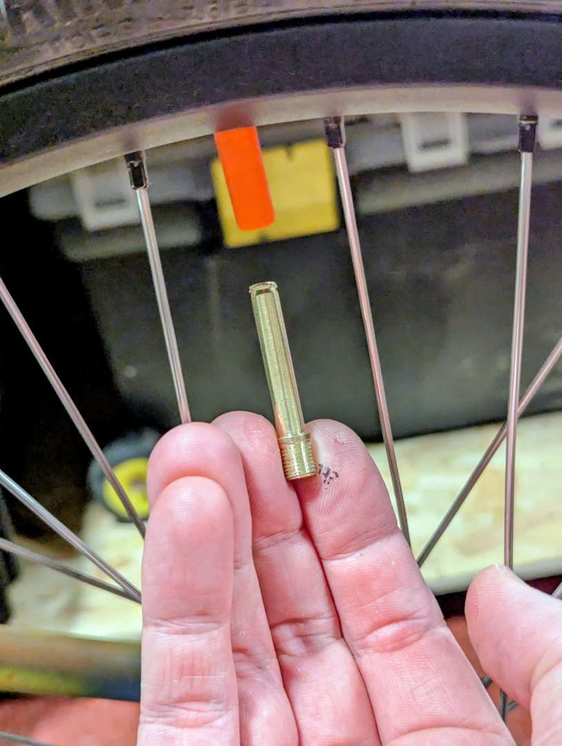

I found a picture of my last Tubolito failure. The valve itself just slid out of the plastic tube like it wasn't bonded in properly.
I couldn't be bothered sending them back again so I glued it back in with epoxy and it's been fine since.
