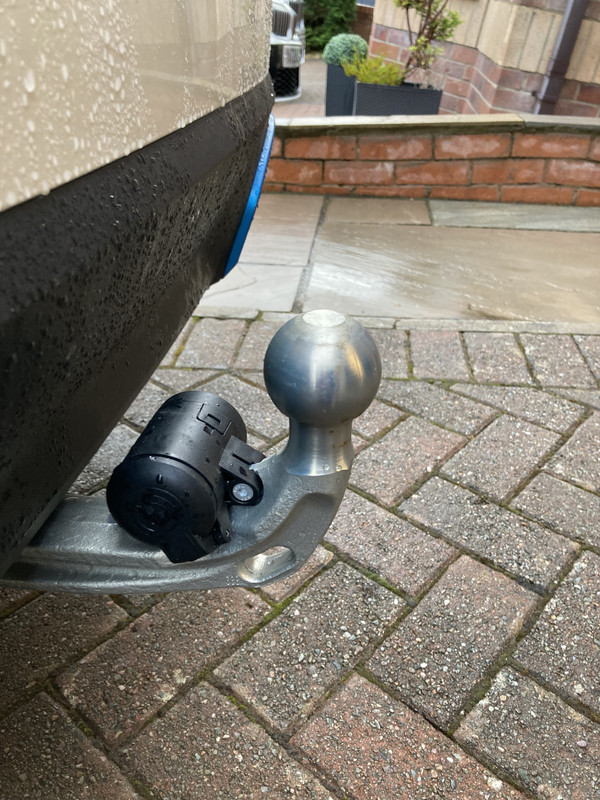

Today picked up a new BMW i4 which I specced with a factory fit electric retractable towball option. Unfortunately the shape of it, as in picture, means that the rack won’t go on, as it needs to enclose the ball and down the stem a bit, and fouls the electric socket…

Can the electrical socket be demounted from the towball and mounted separately?

More practically though - it looks like the socket attached to the metal part with a bolt. Is there any way the socket could be removed and relocated somewhere else, like on the underside of the metal parts for example - would need some form of clip making up.

Thanks, the Buzz clamp does look like it maybe will work, ta11paul - I’m not nearby (Glasgow) but if you could measure the distance it comes down from the base of the ball that would be very useful. The socket can’t be moved.

I'm pretty sure a Pendle wheel support one would go on, and they're bombproof. I suspect to wouldn't fold away with the bracket in place though, and its a 4 bolt PITA to remove.

I’m using a Thule compact on bmw ix3 electric tow hook if that helps
looks just like yours

<p>I reckon pretty much any other make will fit - our atera would as it just clamps the ball itself and rests on the rearmost part of the ball neck until it’s clamped in place. Definitely call roofbox as it looks like this design of tow ball is becoming more common and they’ve probably run into it before.  </p>

@woody71 - that looks identical.  Looking at the Thule website it looks marginal, but if it fits as you say, I'll buy similar Thule rack methinks..

Did some measuring and had a very useful call with Roofbox.  They confirmed that they have seen this recently on a number of their racks and electric retractable towballs, notably the Yakima and some of the Thule ones.  Their recommendation is the Atera Strada range (as per @hot_fiat, many thanks).

Coming back to this with an update. I never really got on with the Atera rack after the ultra slick Yakima one so after some discussion with some very helpful people at BMW I have their own brand one, the Pro 2, which has a clamp designed specifically for these shallow towballs, winging its way to me….

Did you ever try to connect the electrics before putting the rack on? I've got a very similar tow ball on my Volvo with a Takima and it won't fir unless I connect the electrics first.

Hi, I found with the Thule and Yakima racks that the ball clamping mechanism wraps over and too far down the neck piece beneath the ball, so physically just won’t fit.
The Atera, and the incoming BMW one, have a very different shaped clamp.
