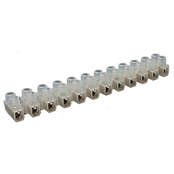

Buy some of these, and cut the wires, it's more reliable than the horrible connectors the kits come with. Other than that, just a few meters of extra wire's needed.
Cars a 3-door '08 Fiesta
It's easy enough then, remove the two trim panels covering the backs of the lights, same as if you were replacing a bulb.
Run a wire from the indicator on one side to the other under the boot carpet.
Wire up the indicators, tail, brake, fog and reversing lamps to the relay (cut the wire, twist the relay input wire to one end, put that and the other loose end into the terminal block and do it up). Some kits have 2x brake, 2x reversing, 2x tail light inputs, unless you're feeling industrious you can just bridge them (most trailers don't have 2x reversing lamps or separate circuits for each brake light anyway, certainly nothing you'd tow with a fiesta). The only remotely complicated bit is figuring out which wire in the car is brake and which is tail. A multi meter obviously helps.
Run a wire under the car to the fuse box, solenoid, or anywhere else you can find a suitable 12V, mine's run to the cigarette lighter socket in the boot to save effort. This is fiddliest bit by far if you have to go all the way to the engine.
There's a plastic gromet under the spare wheel or in the boot floor, drill a hole through that, run the wire through from the outside (the sockets on that end). Then wire that to the relay.
Posted : 10/03/2016 11:42 am
