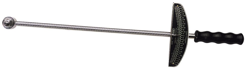

– albeit my torque wrench is pretty old so it may be way out!
And there is the main advantage of the beam type - all torque wrench set will lose accuracy over time but the beam type are easy to recalibrate.  Most click ones are throwaways although the better ones (read expensive) can be reset.

The switch on tengs reverses ratchet but not the torque mechanism .It won't click on left hand .
I have a beam wrench for when I need to torque lefties. - I also need it for applying constant torque to a timing belt tensioner on one of my Cara .
